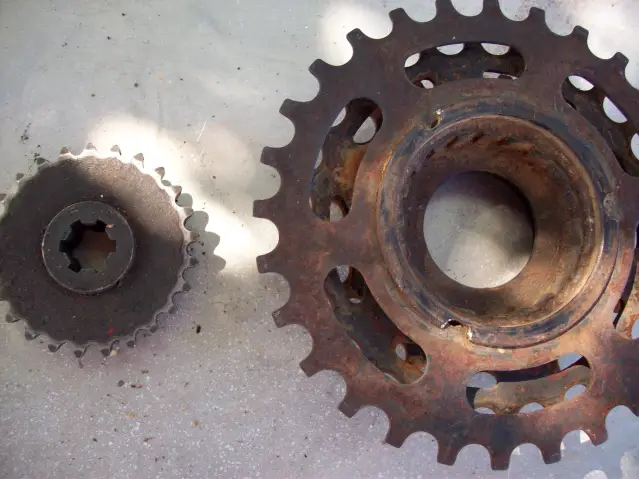

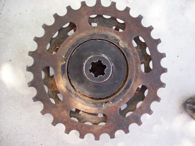

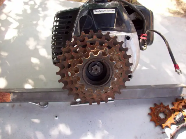

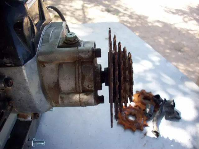

My photobucket is not working so here is some attachment files

The motor will have a single sprocket...I will be using the existing cassette sprocket already on the wheel.
I'm just using this cassette sprocket to mock-up. The gearing will not work...No way will I be able to take off from a stop with this gearing. The motor has a gear reduction with a centrifugal clutch.
The small sprocket is the original that came with the motor..I welded it to the cassette sprocket.
