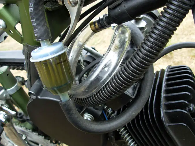

Default Re: fuel filter
This one works fine for me. Also considering that I live on the northern California coast and it rains, drizzles, fogs, etc. most of the year I cleaned out my little gas tank with acetone and coated the entire inside of it with a fuel tank sealer to prevent the tank from rusting. The stuff is expensive but not enough to have to deal with the hassles of clogged carbs and stalling engines when I'm 30 miles from town.
