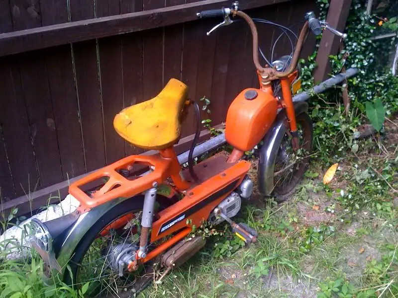

My friend in Gainesville just moved into a new place, he did some yard work in the backyard and ended up finding this little beauty after he cut back a vine that had been covering it. It's a 1977 Cimatti, only has 1,000 miles on the odometer, it's probably been sitting since 1978, heh.

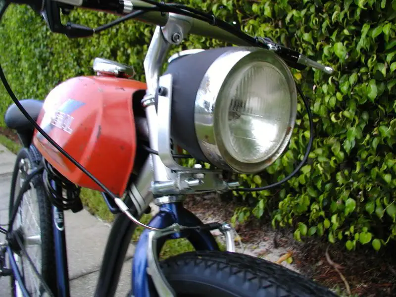

I took the headlight with integrated speedometer and made a mount out of some aluminum yesterday:
it's not the most elegant mount, but it's rigid! I plan on retrofitting an LED cluster into the housing in the future. I think the headlight really makes the bike take on a much more menacing look. I'm going to pick up one of those pyramid mechanical speedos to use the wheel attachment for this speedometer.
