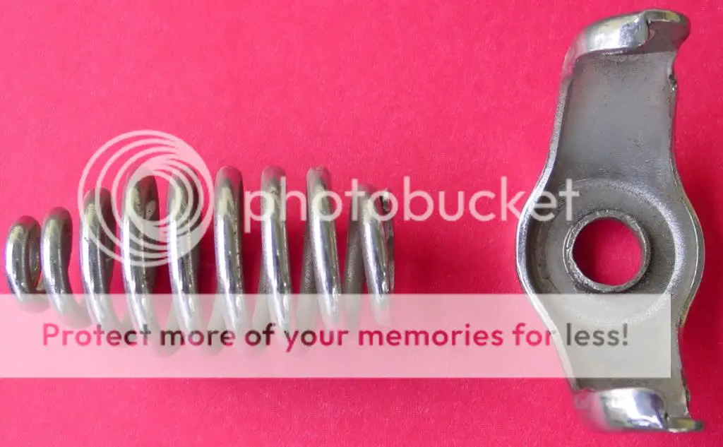

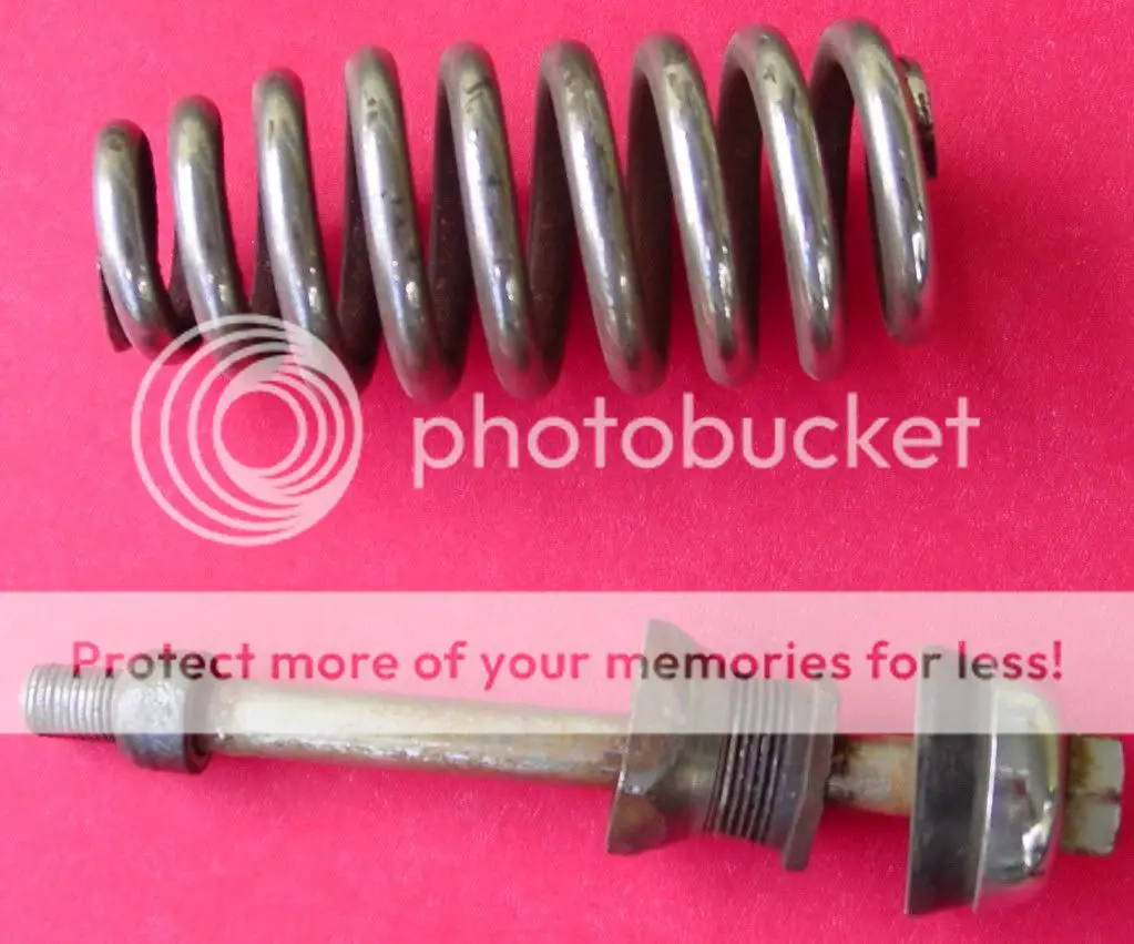

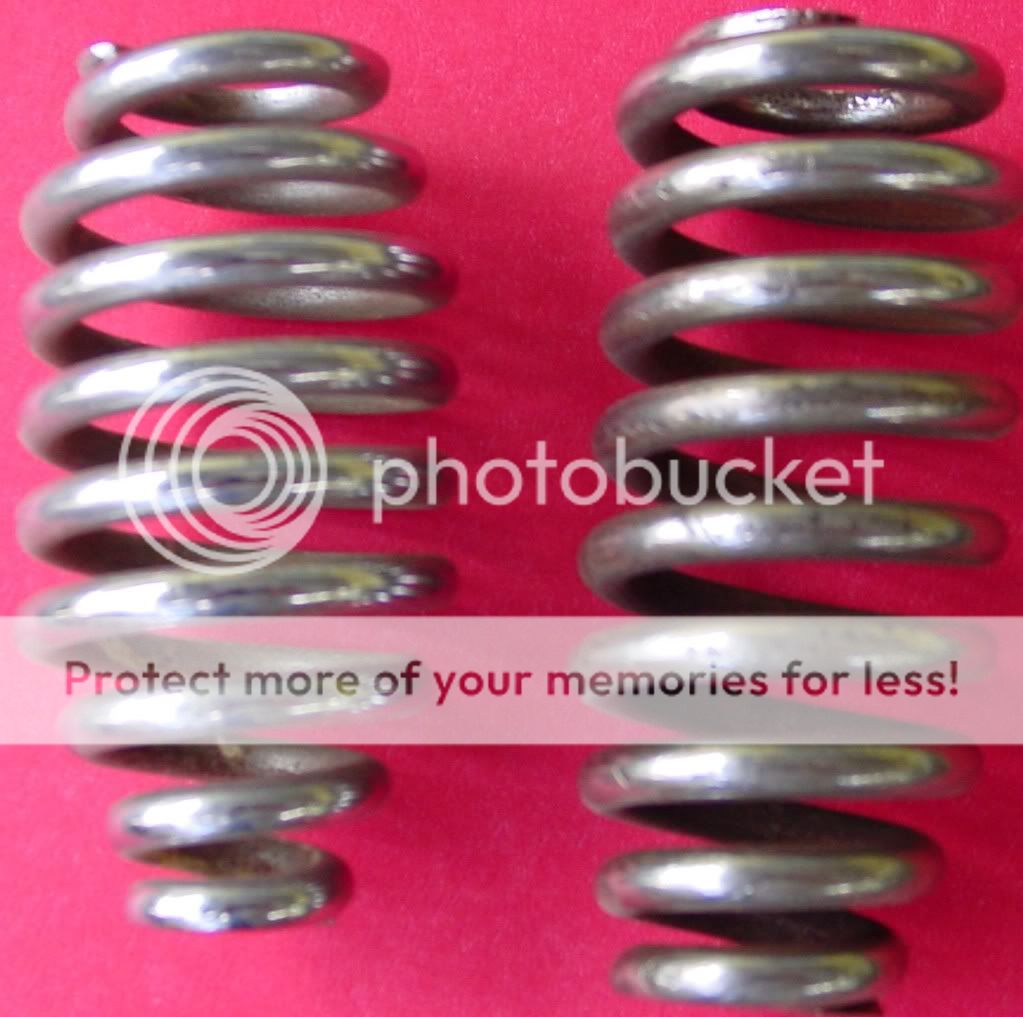

Hey Silverbear. I have a little info on the Schwinn springer springs. The photos show a stock and a Whizzer spring. See how much beefier the Whizzer spring is? Also the earlier springer springs were supported to the yoke with a hollow bolt and nut and a rounded nut at the other end as a guide. The later ones just kind of flopped around. I'm 180 lbs but most of the Whizzer guys I know are over 200 and the stock spring just collapsed with them sitting on their bikes. The Whizzer spring is much more stable and up to the task. I bought a couple for $15.00 years ago, but the latest I've seen on ebay are around $45. May be worth it. You only need one per bike. Hope this helps.
The Whizzer spring is the only way to go, especially when you factor in the additional weight of the engine and the fact that any original 60 year old spring has probably lost most of it's original spring rate. I made the change and it greatly improved the handling of the bike.
You could place a smaller HD spring inside the coil you now have to make it stiffer. You know- just like dual valve springs.
