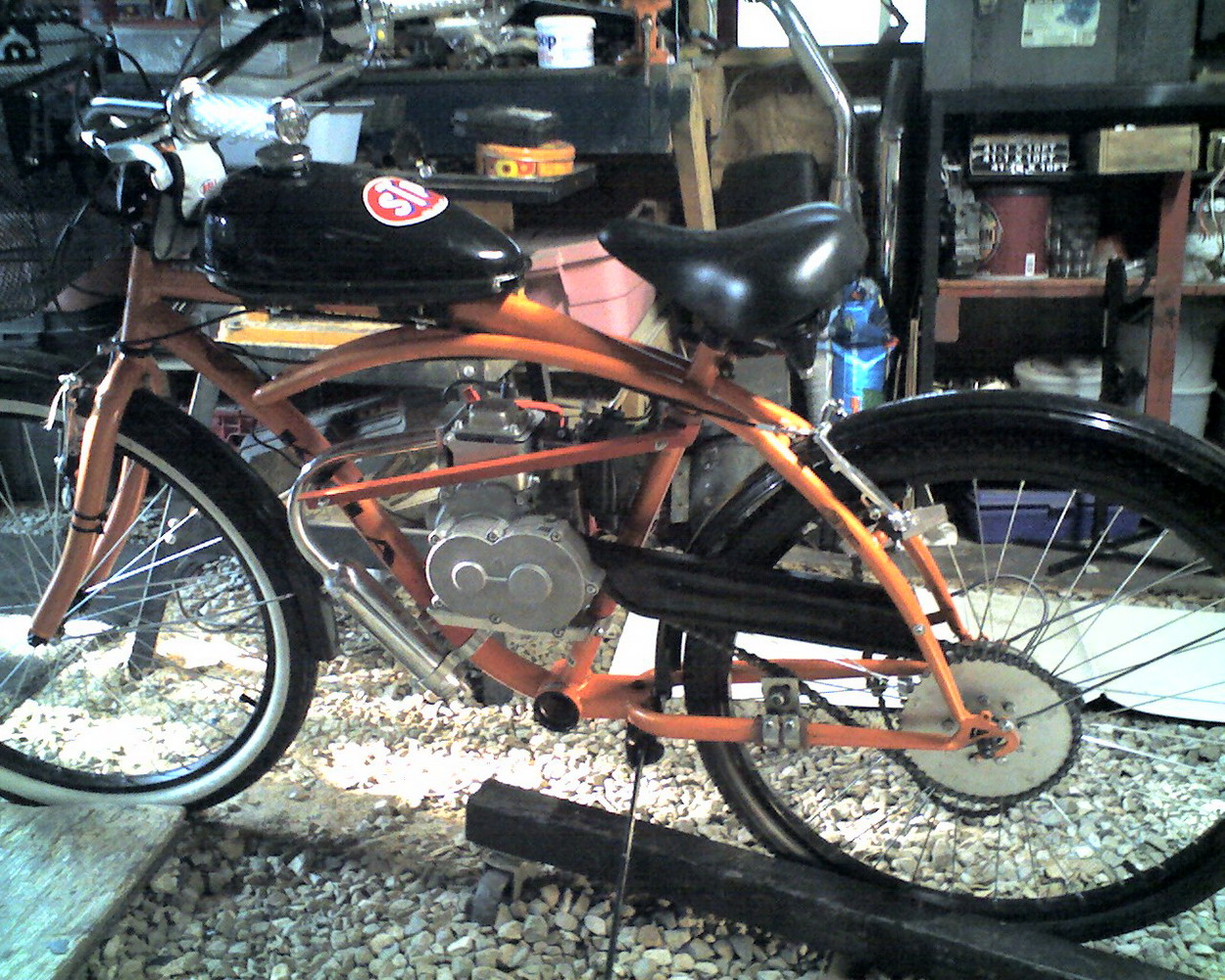

i have one. it was purchased from bikekitsdirect.com for $269. shipping included. there were a couple of issues with the kit but the seller compensated me for them and was polite. this kit requires a square-drive bottom bracket. the bike i put it one had the one-piece crank so i had to order a sealed bottom bracket from bike nashbar for 14.99. also i had to buy a usa to euro adapter for 18.99 (ebay). still it was the cheapest kit i found even with the bracket upgrade. i rode it without the pedals with a 44Tsprocket instead of the 50T they supply. you can;'t really do this cause the clutch clangs too much without pedal assist on take off. it ran really good tho once it took off. felt smoother and more like a motorcycle than my 2 stroke. looks like i have the crappy hooter gearbox.

Boy, Shiloh, I had my credit card in my hand until you mentioned "crappy hooter gearbox.
How important is that, fellows?

A good motor with a bad gear box is like a submarine with a screen door.
It's there but it won't work.

But how bad is gear box?
Is there any consensus on this?
