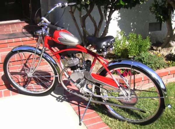

This is my Schwinn, hope you like it. I used to custom paint, back in the day. This is a rattle can job Krylon. Have fun, Dave

beautiful bike. Congradulations

Nice paint scheme!!

That is a really nice looking bike. How do you keep the gasoline from messing up the paint on the tank?

beautiful scallops, I have a hard time beating the runs, much less anything fancy

Actually Krylon is pretty much fuel proof, but I seal it with clear (Engine Kote) I think that is the name.
Some advise, to get a good coat of paint to hang with-out the runs, apply a very thin coat let it tack up pretty good then put a coat keeping a wet edge. You should apply three coats in this manner each one letting the last tack up well, start from one end and move to the other, no spinning around, just back and forth moving along. Hope this helps. Have fun, Dave

That bike is extremely tasty.

very nice. i been thinking about a spring front end for my motor bicycle. do you think it improves the ride or just really nice to look at? both are important but easier to spend the cash if cures looks and ride

I rode the bike for a while with-ought the springer, I think it improves the ride, it is definitely worth the money. I also put one on the Green Hornet bike of mine. Have fun,Dave
