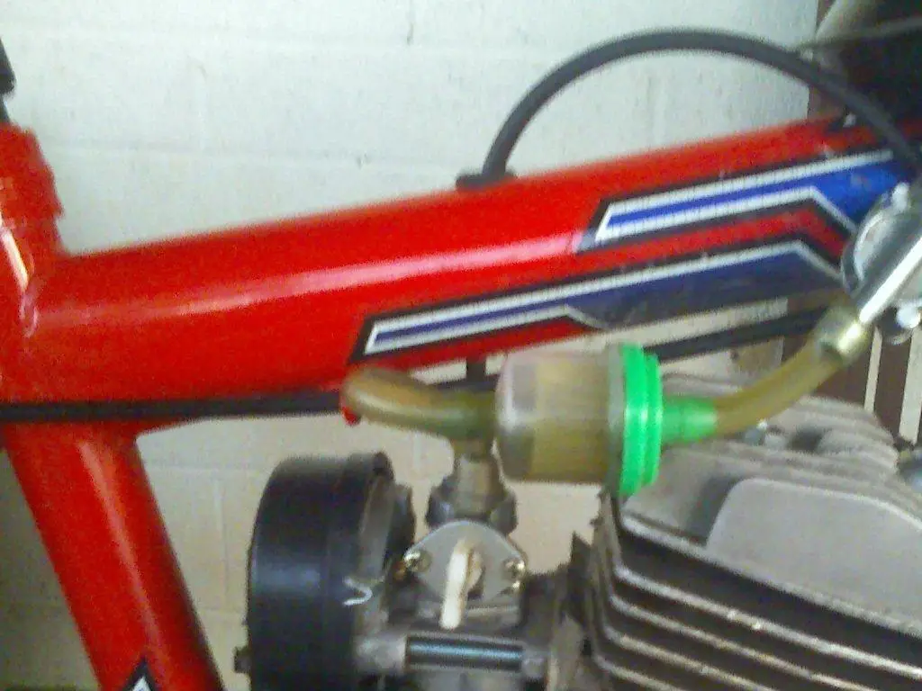

I have built a roadmaster mtn bike- not the latest bike available but the size looks similar. Very difficult- had to drill a hole through the frame to get the throttle cable to the carb and I was using a 49cc engine that had no intake manifold- carb bolted right to the cylinder. My son destroyed the roadmaster and I would not encourage anyone to purchase one with the intent on motorizing- garage sales or craiglist and get a quality bike to start with.

here is a pic of the carb and how tight it was!

Though with most things tight is good, that isn't one of them ;-}
