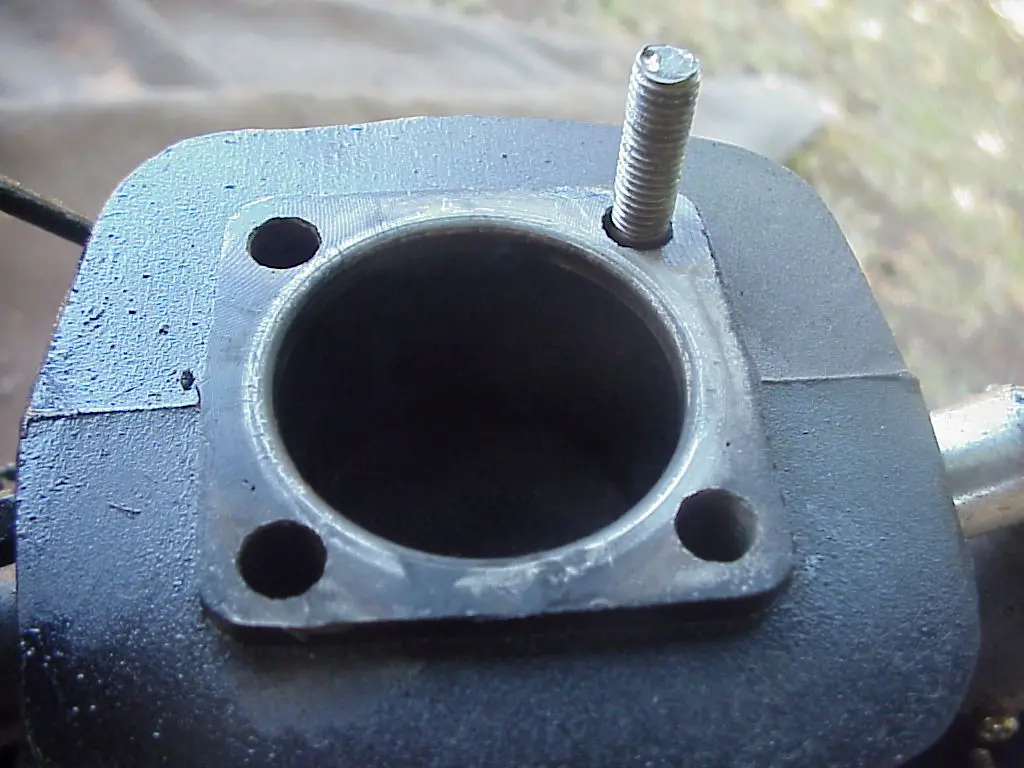

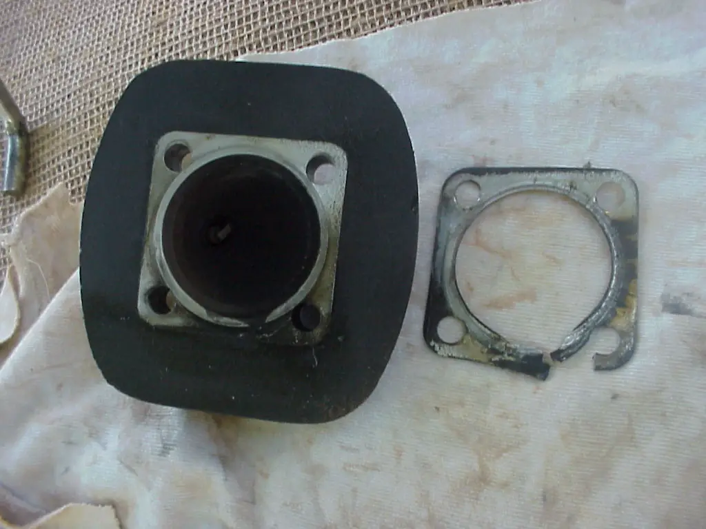

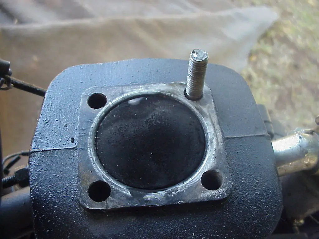

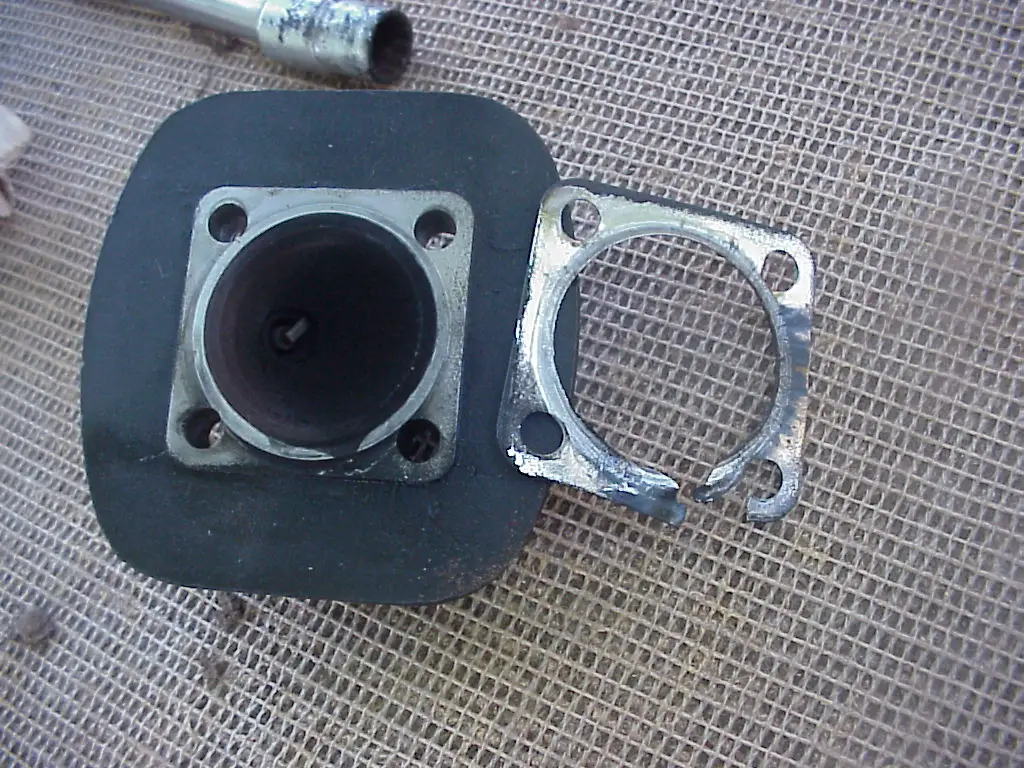

Solution to photos of my blown head cover
Took a minute, but I think I have it now...About the blown head gasket/cover, here they are. The first two are the cover and the gasket, pretty obvious. I feel like an idiot.

Wow! Looks like the nuts were really loose. You may want to dress the jug too. The head bolts pulled out of my BGF motor too when I tore it down but I just re-used 'em.

Re: Solution to photos of my blown head cover
Yeah, I guess I didn't realize that they would loosen off, in bigger motors they don't. Gonna buy upper and lower gaskets, exhaust and intake, too I think. BTW, will the sandpaper on glass thing give me a good enough seal, or should I buy a new cover? Oh, yeah...except the head nuts and loctite.

It should work just fine. If you've ever had a head decked it's the same process only on a smaller scale.
The most important thing is keeping the surface flat as you clean up the gasket surface area. You don't want to sand an angle into it or have high or low spots. Go slow and don't apply too much pressure but concentrate on keeping the mating surfaces flush with each other. I hope that was understandable.
If I can make one more suggestion it would be to discard the chrome acorn nuts that come with most engines and use shouldered hex nuts in their place; especially on the cylinder head. There have been reports of the acorn nuts tightening on the stud before they make good contact with the head which can lead to blown gaskets as easily as loose nuts. Proper torque is also important. 10 to 12 foot pounds (110-120 inch pounds) is a good figure to shoot for. Criss-cross your tightening pattern...side to side.
Many of us shy away from LocTite but if you feel you need it, do not use the red lable product. You'll have trouble later if you ever need to disassemble anything. Use the blue label type only...if you must. It's not necessary.
Hey, tom, excellent advice, and i have seen a resurface job, kevlar. Thanks for such precise instructions. Didn't know about the loctite, but you can never be too sure. I'll not use it on the cyl studs. I am glad for the torque specs though, I would have went for around 20 ft.-lb. Your instruction was quite understandable. Give yall a report when I get her done, just need the patience for the gaskets now.
