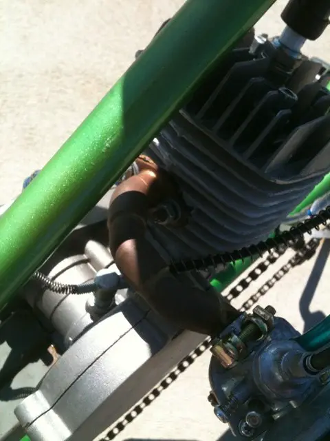

Hi! new to this site, and i'm also not very technical. . . . . the boyfriend is the one doing all of the work. . . we are putting a motor on a 1958 schwinn twinn deluxe, that we have brought back from the grave. . . . trying to find the perfect place to put the motor, without altering the frame.
we have found a spot if we can make or find an elbow for the carburetor, and have it go off to the side around a bar that is in the way.
Is this possible? what is the name of the part that connects the carb to the motor? would we have to fashion one ourselves, or are these tubes standard at a hardware store?
we need something with a 90 degree angle and the same bolt pattern. . .

"intake manifold"
Which is a touch odd as "manifold" would infer more than one inlet/outlet... but I digress lol
Anyhoo, while I would advise making your own by modifying your existing one or making one from scratch, this may be challenging if you've no access to welding equipment or friends who do - there's the "offset intake manifold" that's worked for a few folks with the same problem, while it may not be perfect... for $7 it may be worth a shot

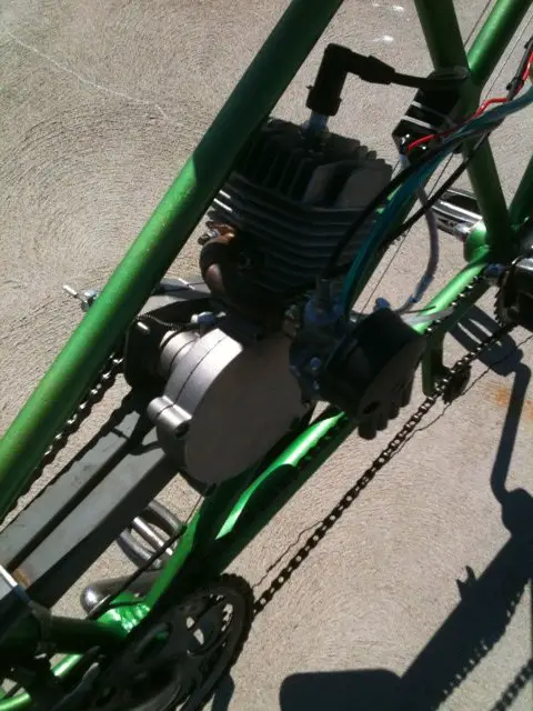

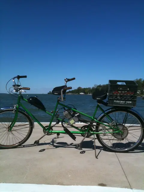

Well, thanks for the help!! It's done, I think he put 14 he's into the build, still modifying as we ride. It's awesome! I will post a pic on this thread when I figure out how. (p.s. He made his own intake thing/manifold) took a minute to get used to, because my knee sort of hits it when I pedal, but I got used to it and adjusted my body mechanics. Thanks again!

here is a couple of pictures! 1950's schwinn twinn deluxe with a 66cc motor.

Nice job on an unusual build. Tandems can be a challenge but it appears that this one is a success. Congratulations, have fun and ride safe.
As for hitting your knee when pedaling: Don't pedal...let the guy and engine do the work and you just sit back and navigate
