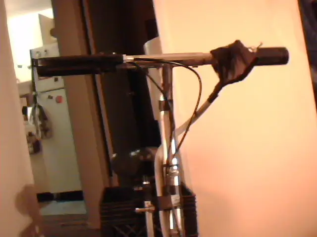

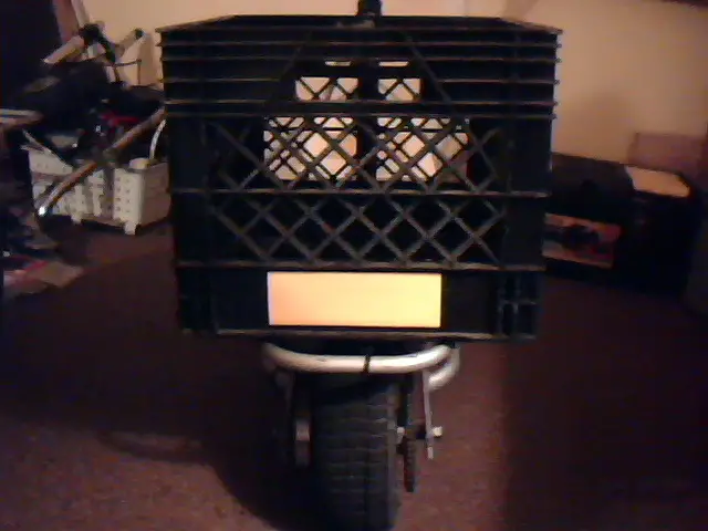

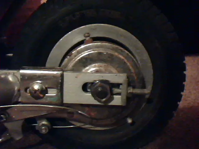

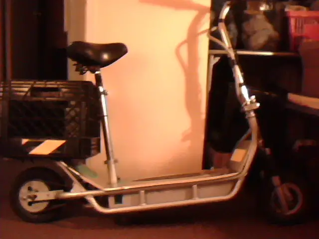

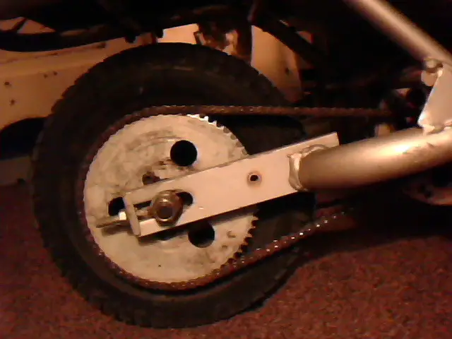

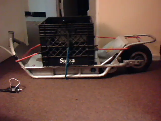

Since im woking on building a new bike trailer, i rebuilt a scooter out of another frame i had and heres some pics:

Its got a 24v 600watt motor, 2 12v 20ah batteries,1 50v 50amp breaker/toggle switch as a fuse,and a 50v 60amp toggle switch for on/off,it has 2 speeds: off and 12-15mph.
When i used a scooter just like this one as a powered bike trailer, it would push a bike up to around 20mph.
This scooter is like a tank,it will go over grass and up hills.
It also uses a stock 24v scooter charger that plugs into the charger port on the side of the scooter. I wired everything with heavy duty very thick copper wire,as you can see the large grey cable in the pics.
It also has a drum brake that works.
I also chopped the handle bars to lower them to look more like a handi cap scooter.
Next im working on adding 2 more wheels to the rear.
