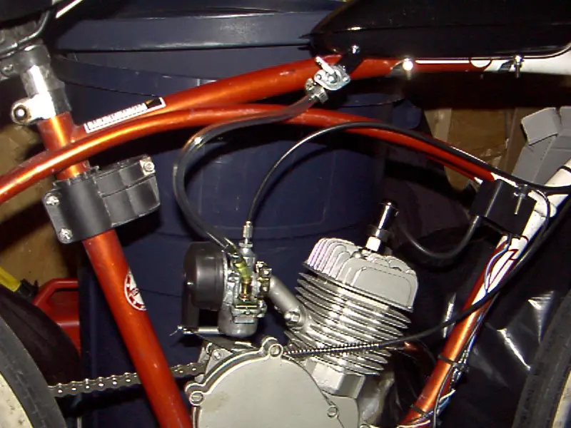

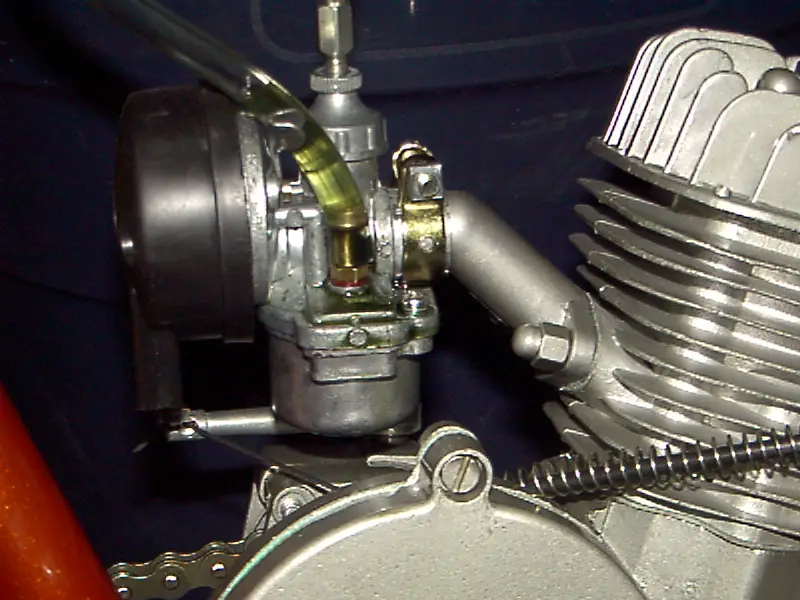

Hi ya all,
So my fuel line doesn't fill up all the way. I finally got everything installed and ready, but the engine doesn't start.
It putters when am pedaling and slowly release the clutch, but no start.
The fuel line doesn't fill up all the way. I am thinking there some type of air trap, where the tank/line needs air in to allow for fuel down and out into the carb or something.
But if you look at the pictures below, does this setup even make sense? I mean, all I got in my kit was a fuel line that is supposed to be connected directly to a valve on the carb.; no clamp no nothing??
Any thoughts are appreciated.
Thanks,
Andrew

Just pinch the line a few times it will fill.....

IT WORKS!!! IT WORKS!!!
Thanks much for the tip...now I just have to make sure the bike is equipped for all the vibration

Put a wire tie wrap around the carb inlet hose - it looks like fuel is spewing. I recommend losing the in tank filter and using a plastic inline filter.

Am I the only one that noticed his valve on the tank was turned off in the picture?
I imagine by now he has figured it out though this post started over a year ago LOL
