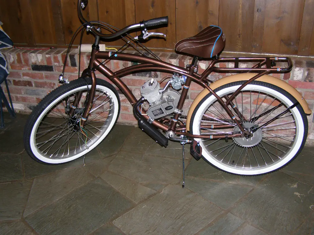

After watching motorized bikes in the campgrounds at Oshkosh for several years, I finally decided I had to build one of my own... Did some research, found this forum, opened up the purse strings and ordered some parts!
For a list of stuff I bough to build this bike, see this post later on in this thread.
I'm not the most disciplined when it comes to documenting my work, but I wanted to make this thread a decent description of things that tripped up a first-time bike builder. For you experienced guys, I'm sorry about the excessive prose but I'm hopeful it'll help someone down the road.

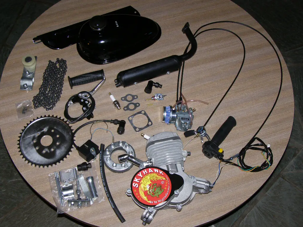

I ordered a 2010 Grubee Skyhawk 66cc kit from gasbike.net, mainly because they had a coupon that covered the shipping cost. Turns out they have a pretty good recent reputation as well - I was very happy with the service I got.

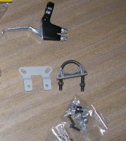

I settled on a Huffy Nel Lusso because I like the frame - the welded-in luggage rack was a big part of the decision. I've never been a big fan of coaster brakes anyway, and with the extra weight of the engine I just didn't feel comfortable with them in principle. I ordered a dual-pull brake handle from SickBikeParts.com. With my left hand working the clutch, my right hand will have to handle the braking chores and this way I can get both brakes working. Should have no trouble stopping...

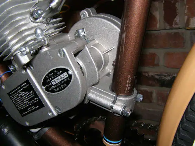

The Huffy cruiser frames have the right sized seat tube for the rear engine mount, but the downtube is oversized and slightly oval where the front mount will have to go. I ordered the universal front mount kit from SickBikeParts.com, and it looks like it will work well.

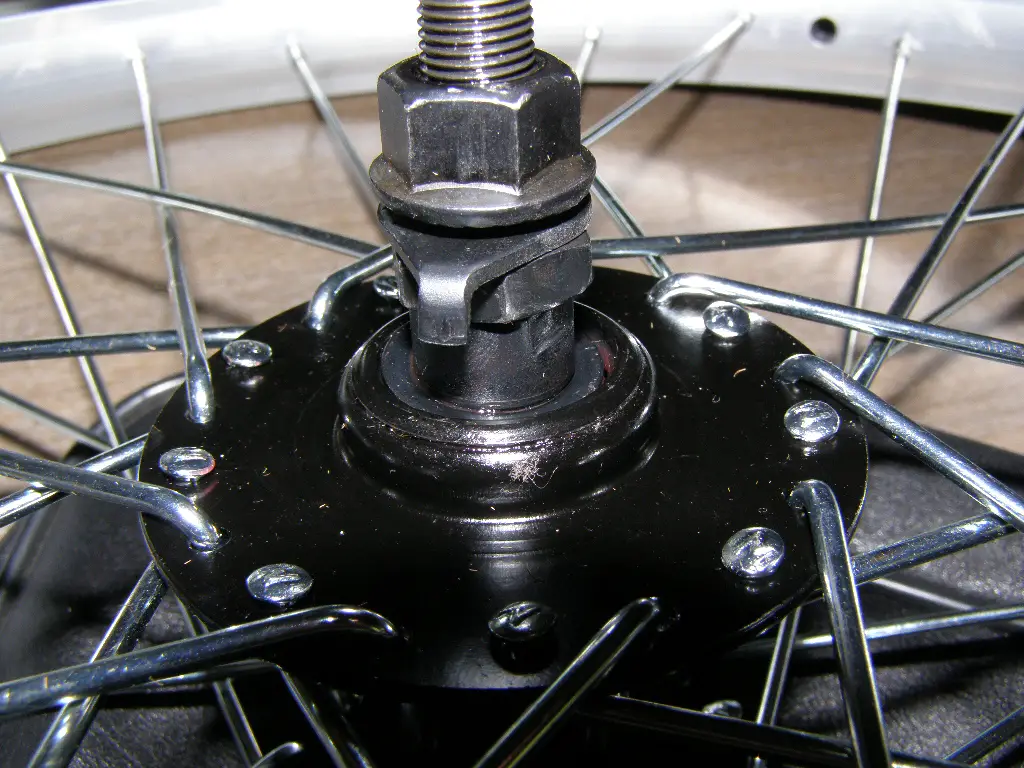

My front hub was very "crunchy" and tight out of the box, practically screaming for some lube. Word of caution for the next new guy, you NEED a 13mm cone wrench for this...
Park Tool Website
I didn't have one and decided to try anyway. I could not get the lock nuts loose from the cones and mangled one of the dust covers in the process... I don't think the dust cover is critical for holding things together but it does protect the balls from the outside world so it's important. My local bike shops all tell me it's okay to ride the bike in its current condition but I'm not too sure.
Regardless, I can't get parts locally. The local shops all plead ignorance of these "cheap bike parts" and none were willing to install a new brand-name hub or order a new wheel. Huffy claims to have all parts you might need, just a phone call away - so I called them. The don't sell component parts, only components. So I can't get the dust cover from them, but they will sell you a front wheel assembly... Except they're out of stock for the next 4-6 weeks.
In the mean time, I'm going to work on the brakes, fender reinforcement, and engine mounting. I'd like to paint the tank and some of the components too...

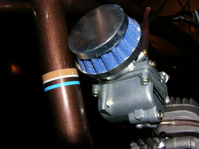

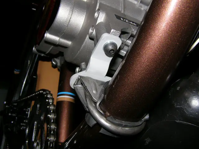

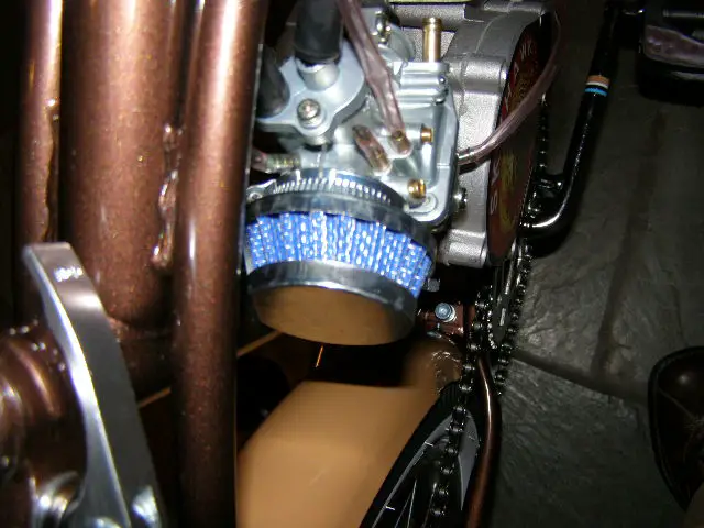

Here's where it sits this morning - I got the engine, carb, and exhaust mounted up last night for a fit check. The air filter has just enough give to it to flex away from the seat tube, but rides the tube pretty hard. I'm tempted t just leave it, since I'm not sure I could put a little bend into it without destroying the part or restricting the airflow. There's always the aftermarket option - offset intake manifolds...
Piston Bikes Offset Manifold
Engine mounting is solid with the universal front mount from SickBikeParts.com, so I think I'll leave it mounted the way it is. I used scraps of an old intertube between the frame and engine mounts to cushion things - this makes engaging the rear mount nuts a bit tricky. Hopefully the reduction in vibration will be worth it.
The crank hits the muffler a little bit. This new Grubee kit has some sort of heat shield on the front side of the muffler and that's what's rubbing, but I don't really want to remove it. Options are a new wider crank or some slight exhaust modifications. I'm leaning towards "reshaping" the exhaust manifold...

Just bend it ! Take it off the bike first though. Looks like you only need to bend it out away from the engine a touch.
Huffy Tip : Their seats look cool for about a week then start falling apart. Get a new one coming ! Also the peddles fall apart too.
I would remove the rubber between your frame and mount too. It will just lead to problems.
Where is your coaster brake arm ? Looks like its not even on there or hiding very good.
