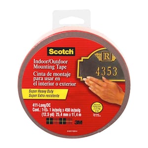

Originally Posted by Venice Motor Bikes View Post
A trick that I learned for mounting the tanks, is to put some good 'double sided' tape on the top tube of the frame (to keep the tank from moving) so that you don't have to tighten the tank studs too tight (& possibly crack those welds.)
Very good point. I use this Scotch Exterior Mounting Tape
With this tape you almost don't even need to bolt the tank down. You may find when you remove it it'll take the paint off your frame and tank before it lets go.
