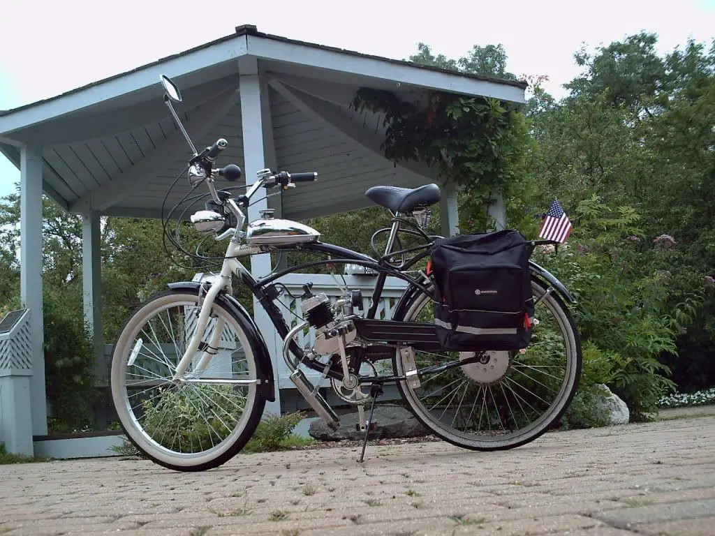

i recently built two bikes. one gas and one electric. i'm not sure how to post the pictures but i should have them on here as soon as i figure it out.
the black schwinn riverside cruiser is gas as you can see by the picture. it has an 80cc daemon two stroke. it was my first 2 stroke build and i didn't have any major problems except for very poor chinglish instructions that came with the kit. she runs great and i am out on her almost daily, buzzing around valparaiso, indiana.

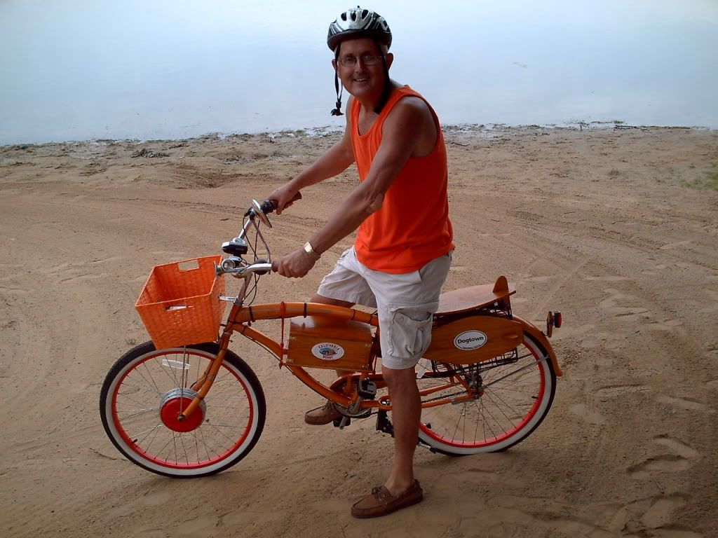

the orange micargi cruiser you hopefully see in the pictures is an electric front wheel hub mount motor. actually, i built the crystallite kit about four years ago, and aside from needing to install a second set of sla batteries, it has not given me a bit of trouble. it will travel about 10-15 miles per charge, depending on the terrain and wind conditions and i've had it up to about 20 mph (a little faster going down a slight grade)
about two weeks ago i decided to turn the micargi into a "surf cruiser" (i made up the title). the batteries had been held in a cheapo black bag on the rear carrier. i found a bunch of oak dresser drawers thrown out on someone's curb. i busted apart the drawers and built an oak box to house the three sla batteries beneath the top frame member. i also bought a 3/8" oak board and cut out 3 "surfboards" and attached them to the top and two sides of the carrier. then i cut out a small surfboard of oak and attached it to the rear fender to hold a tail light. i brushed several coats of amber shellac on all oak to make it blend in with the orange frame of the bike.
i took off the original black metal basket on front and mounted an orange fabric basket i had found at our local michaels on sale. i cut and shellaced a piece of thin plywood to put on the bottom of the basket for additional strength.
lastly i ordered several retro surfing/california/venice/santa monica/woody decals to put on the battery box and the surfboards. although i live in northern indiana, all my life i have spent a lot of time in the venice/santa monica area of west l.a. so the theme is kind of nostalgic for me and brings back lots of so. cal. memories.
which one do i enjoy riding the best? that's a good question and i still haven't decided. they each have their good and bad points. next i am thinking about building a micargi general cruiser, which is painted in olive drab and has a tan seat and grips. it has a definite military look. i'm thinking of putting a crytallite electric front hub motor on it as well as a chinese two stroke. if i could pull this off, i could ride using the electric motor until the sla batteries discharged and then start up the two stroke for the rest of the ride. i don't know if others have tried this but i kinda go that idea from reading about the chevy volt that is coming out soon. it will have a gas and electric motor, although of completely different kinds. i dunno, i'm still thinking about it.

Love the battery box. Well done.
