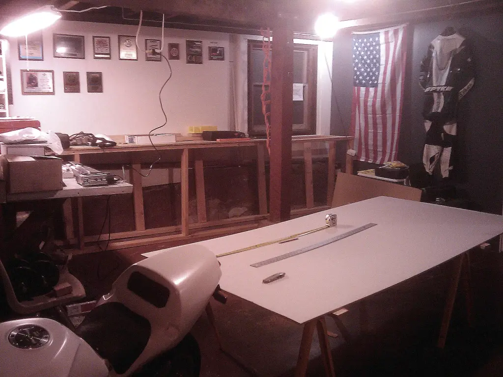

Hello,
Thanks for the comments. Polite comments I should add. Actually, I made a couple mistakes. I was thinking of a single speed mountain bike. I dont know why I said fixed gearing.
And I suppose that since I wouldnt be shifting I wouldnt need a shift kit. I guess that was a silly question.
My plan is not to use the bike offroad much. Here in Northern California I think that I would stand out too much in any of the bike trails. And that would be a really bad thing. I am planning a 90/10 application bias towards the street.
Anyway, I hope to get this on the workbench soon. To be honest, the reason I have not started the build is because I am building a workbench and tooling area. I want to have a proper area to work on my bikes (and motorcycles). I just bought a house in San Francisco and have been rebuilding for the family. The garage phase started about 2 weeks ago. Currently working on a 13'x18"x3' work bench with cabinets underneath. Once complete things will start to happen.
Thanks again folks.
Miguel

Old 08-05-2010, 04:02 AM
BarelyAWake's Avatar
Join Date: Jul 2009
Location: Maine
Posts: 5,622
Default Re: Fixed gear Mountainbike, Shift Kit ???
Nice shop space man *drools w/envy*
Not to worry about "mistakes" bouncing ideas both good & mebbe not so good is exactly why we're here as I see it - heck, even having a jackshaft on a single speed isn't "silly" - just different is all... ya might even wanna give it a go jus' for giggles - you could always add gears later if ya wanted.
You've no idea of some of the truly odd things I've daydreamed up lol it's all part of the hobby I figure
