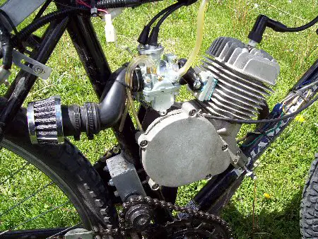

Hi all, I took the bike for a short ride last night after tinkering a little but when I got back the engine was so hot you could have fried a bacon samich on it, though I burnt it up for sure because this morning it wouldn't start, wouldn't pull fuel. This afternoon I took the walbro style carb off and put on the carb I had on it and all is well, still missing a little but much better now. Which is the carb shown in pic. Whewwww. If you notice the hose and air filter attached to carb, now, if I run it on the carb the motor starves out at wot but runs fine without it. Absolutely no restriction in the air filter or hose what so ever. Still haven't figured that one out. Also have taken out the manifold extenders too. Well as they say back to drawing board and keep plucking away at, will be back tomorrow, god bless..

Sounds like you only need to richen the H or high speed screw for WOT performance.
What model/size is it?

I was experiencing something similar with the same carb as Tech2353. Turns out that I had to set the pin to the leanest setting (top notch) and set the mixture adjustment to the leanest as well (The screw to the left of the idle adjustment. Fully turned in).
Remarkably the plug shows that it is still running a bit rich but at least now it runs well.
