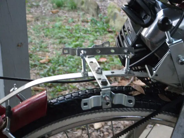

Thanks to two recent customers, Danny Uttke and Jack Shields, who both have years of bike experiences, for the ideas.
I'll describe it here, and am going to modify Rocinante today and tomorrow, so will have pictures.
The first is simple, Jack says a better front strap angle, heavier, taller and longer is available at Lowe's hardware. A 75 cent fix.

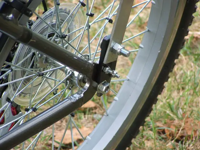

Danny bought some rubber washers, larger ones to put between the main engine mount and the steel blank I attach to the frame. I bored holes in the sidewall of an old tire, cut them out and put them over the mounting bolt, between the two pieces of metal.
To make the gas tank angle better, I bolt together a "strap and a half", 6 available holes instead of 4. Danny bought rubber sink washers, bored them out, and sandwiched them between the straps.
Engine vibrations on the 32cc Tanaka is NOTICEABLY reduced.
Here are old frame mount photos so you know the two spots I'm talking about.
Pic #1- There will now be a rectangular piece of rubber cut from the tire sandwiched between that metal mount application.
Pic #2- The new Lowe's bracket angle will supposedly be 1/2" taller and longer than the pictured one GEBE provides.

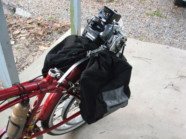

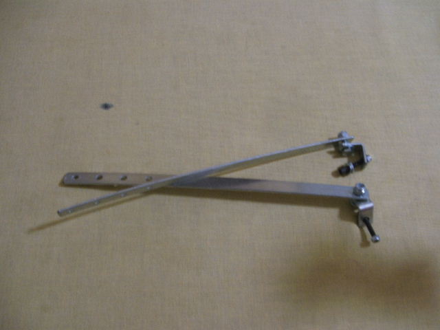

Pic #3 - The butterfly contraption is to push out the saddlebags, but notice it is two straps bolted together, to push the engine back. There will be sink washers in between the two straps, and maybe another where the strap connects to the Lowe's angle.
Pic #4- Saddlebags used in the space over the front strap, pushed out thanks to the butterfly piece.
