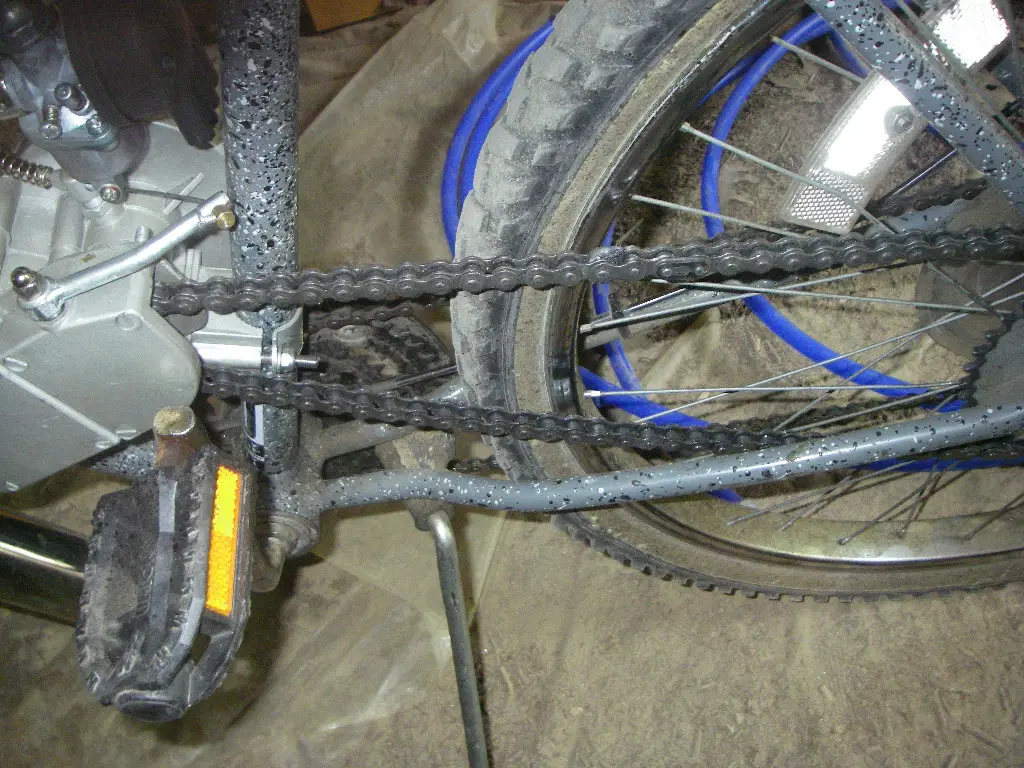

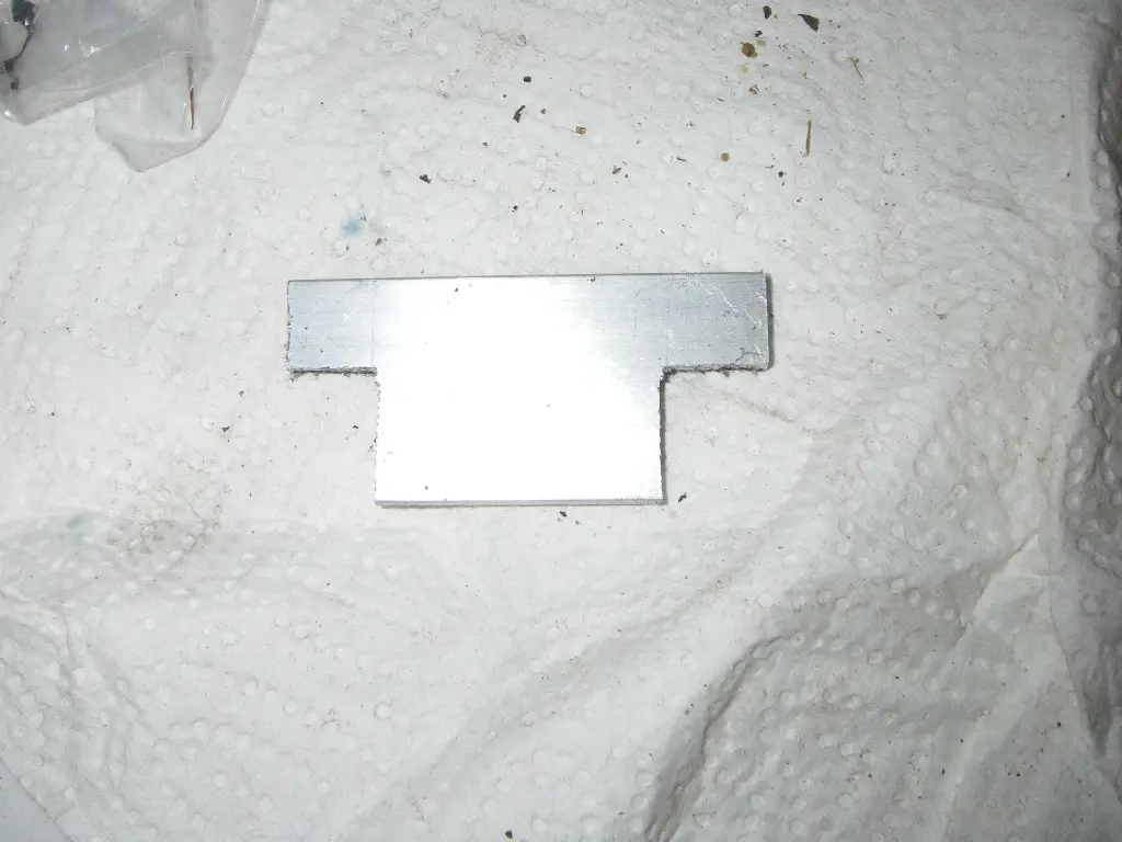

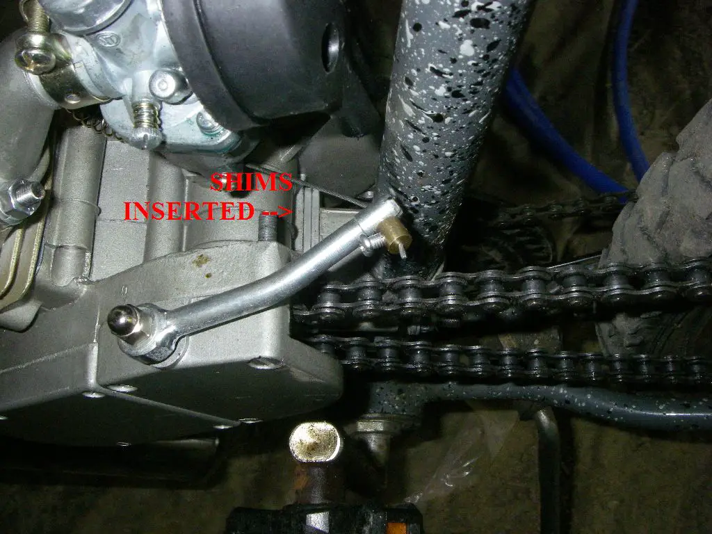

The best thing I have done on my bike so far is remove the chain tensioner. One link is about 1 inch so you only need a half inch of engine movement to fully adjust the chain. I made three shims out of 1/8 in flat aluminum stock which gives me all the adjustment I will ever need. I cannot remember who I got the idea from, but he called the inserts 'T Shirts' because of their resemblance. Just loosen up the engine and drop them in place. If the chain gets too long just remove a link and start over again. The chain runs much smoother now and no more messing with the tensioner or worrying about it rolling into the spokes again.
Edit: I forgot to mention that you may need to lengthen your rear engine mount studs. I made mine longer when I replaced all the studs but I do not remember how much longer I went. I made the longer studs out of m6x1 8.8 threaded rod from mcmaster.com. The shim stock I got from the bin in a hardware store. I think it was an Ace but most hardware stores have it. With a sharp hacksaw blade and a vice to hold it in place you can whip them out in less than a minute each.

Cheers,
Paul
50cc Slant Head mounted on a $5 Huffy mtn bike
