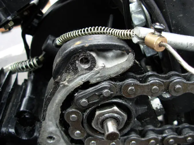

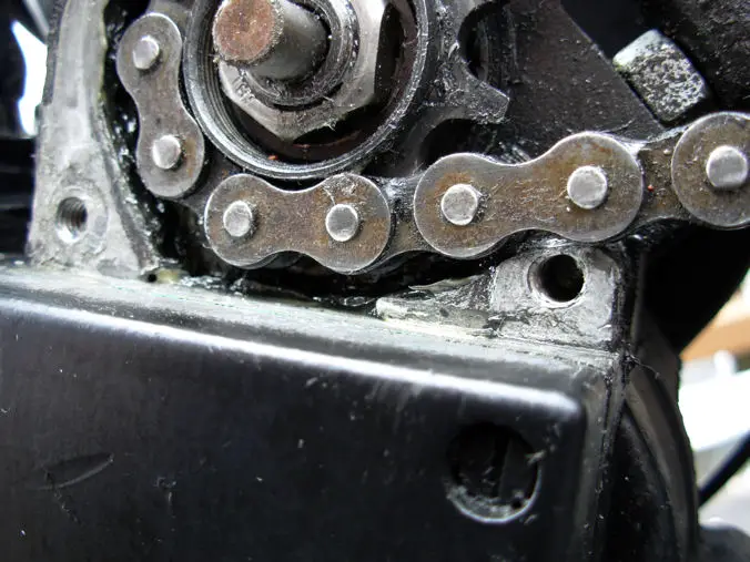

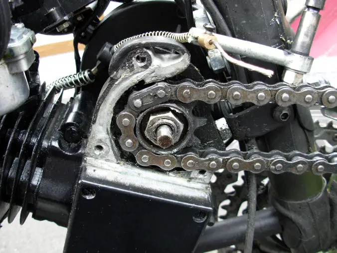

Howdy! I had the exact same issue with my bicycle. This was just one of many serious issues I had with my build. Probably more so because on my very first try to start the engine I nearly broke my ankle at the full force of the downward stroke on the pedal. The chain bunched up inside the engine around the sprocket and the casing and locked the wheel up.
After an hour recovering from the sprain I came up with a solution. I formed a couple of 1/2" by 1/8" steel bars around the sprocket. I secured then in place with JB Weld. See attached pics.
I believe this is a design flaw. Also, I have a rear wheel suspension which may have contributed to the chain accident. After I made the modifications I never had an issue with the chain bunching up again.
