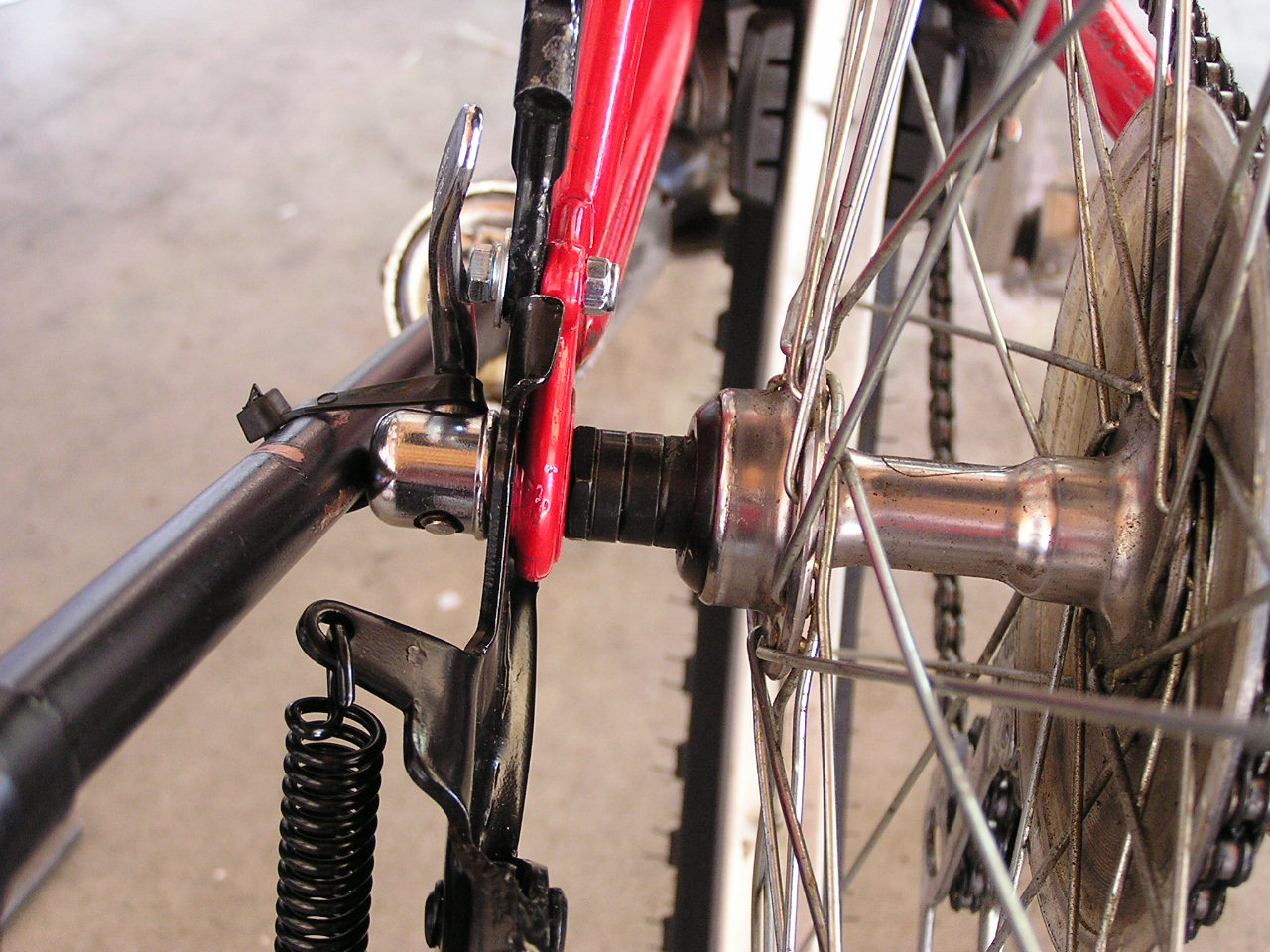

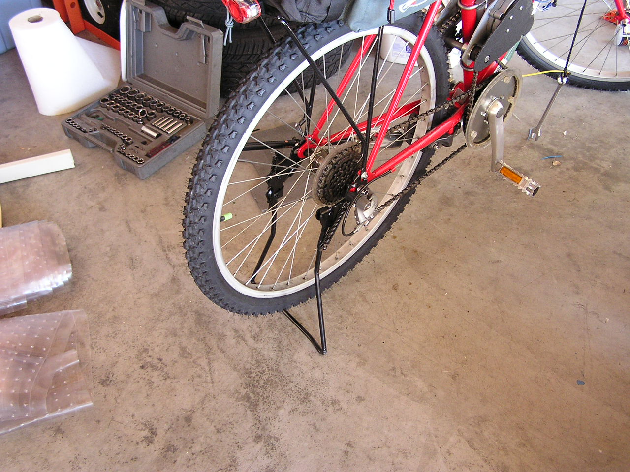

I added a cool hoop style kickstand from Spookytooth. (see pic)
I did have to do a minor grinding mod to the right side of the stand to make it fit on the rear tangs just right. Works nice and has a locking position. After years and years with this bike, it took a motor to get a kickstand!

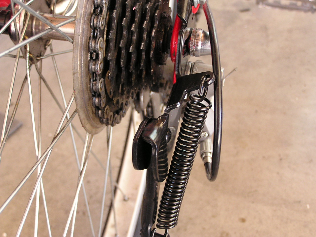

My question: I have quick release rear hub. It's extremely nice and heavy duty. But with added width of the kickstand the retaining axle screw doesn't make enough thread engagement for comfort....it works, maybe 3-4 threads or so, but I want more. Is it ok to remove what I think is an axle spacer? See pic #2.

i think those spacers are because the bike originally had a disk brake on it and someone removed it and needed to fill the space. try to remove one and make sure you do not have to bend the frame to make it work right. the kickstand you got i do not think you will be happy with. i got one like it and it rattled big time while riding. i ended up getting one like this which was a little pricey but i am really happy with it. its heavy duty to say the least

I alway's thought that the extra spacer's were to help keep your tire in the middle. Try it, if the wheel is still in the middle...go for it.

You could be right - but they are spacers.....thanks.
I wonder if they make longer axles! (here we go again with the threads!)

hi; yes you can get longer ones they are just bolts but you "might" lose quick release. mitch

I got it to work fine. I now have plenty of thread engagement. In that stack-up there was a smaller spacer that really isn't visible (looks like part of the fatter spacer in the above second photo).
I also took the hub all apart (bearings and races were perfect) and re-greased it. Nice.
Last night I painted the tab part that I ground down - that tab would go where the dérailleur mounts, but really doesn't effect functionality. Here's a shot but you really can't see much.

Kick stand is very nice. I actually feel kinda spoiled to have a stand! Didn't rattle today or anything.
I would say the only drawback is my rear tang area is pretty busy now...with a quick release, stinger, kickstand.....more of a pain to take the wheel off, that's for sure.
