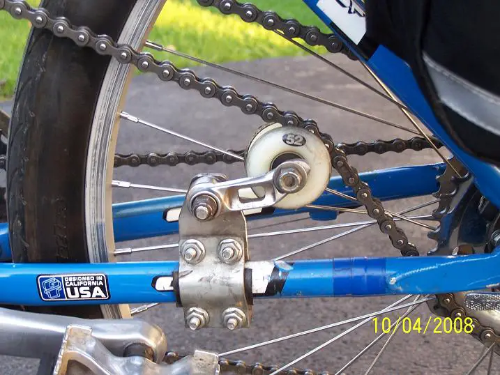

have you seen mine! I used a shimano brake arm that had a round torsion spring built within the arm made a new bracket with a single hole for bolt to pass through and several small holes around it for adjustment of spring tension. kinda like whats on a caliper style v brakes with a post mounted on the frame and the small plate with the three holes for the spring.(you know what Iam saying) and then grooved a skateboard wheel for the chain guide. just my own way of making something better that worked for me. FileStyle
