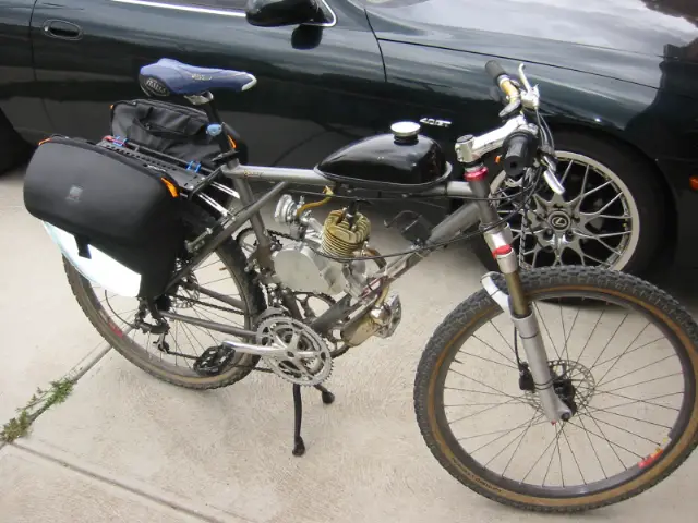

I have made many motorized bikes over the years and would like to show you some of them.
I made this one about 5 years ago, The engine was noisy, smelly and unreliable but this build made me see the light. Running the motor through the gears is the only way to go!

is that a front free-wheel system? and if not, how in the world did you manage on the pedals?
that bike is an inspiration thank you for posting pics of it and if you have any pics of current bikes I sure would like to see those as well

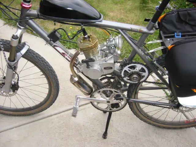

This bike drove the pedals via the left crank, the motor freewheeled if off so I didn't have to turn the clutch or chain. It wasn't too bad pedaling constantly until you get to a tight corner.(you have to pull the clutch in to stop the pedals turning and catching the road.) I seem to remember a top speed of 84kph down a slight hill (50mph?) although I was also pedaling my butt off.
The later bikes all freewheeled for safety but I have since changed to GX35 Honda power.
I have to find some more pics...

What kind of engine is that and where did you get it. I know someone who has a similar engine. That is a good smoothe engine. Where did you get it?
Old 07-09-2008, 04:52 AM
Scotty Scotty is offline
Join Date: Jul 2008
Location: Melbourne Australia
Posts: 32
Default Re: Scottys bikes
I dont know the brand other than Chinese. Its a Fleabay special 49cc 2 stroke.
I changed to a pocket bike 49cc 2 stroke on the next bike but it went too fast.
Now I use the honda GX35 4 stroke which is perfect, 100km to the litre (or 240mile to the gallon I think), at about 30mile/h average speed, and no stinky exhaust.

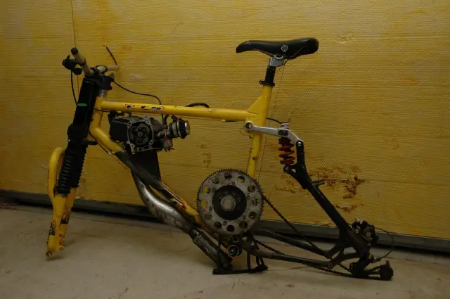

This is the first freewheeler, way too fast. The frame failed at the downtube after 1000km.
