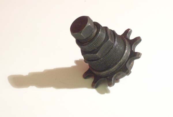

I would like to remove the small drive sprocket and place a washer behind it. Is this possible and if so, what is holding the sprocket on other than the visible nut? My chain is barely rubbing the tire as it comes off the bottom of the front sprocket.

Did you get the "mystery tool" that comes with most kits? That's the sprocket puller.

I did get the mystery tool and did not know what it was for but will certainly try it out!
