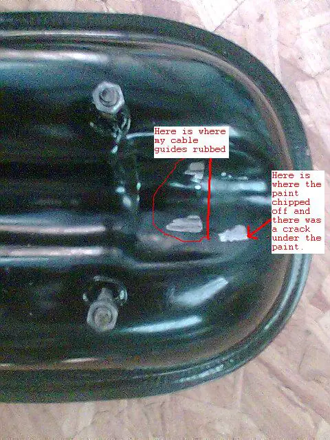

Here is the big problem. This morning I added gas to my tank to fill it back up. I put the cap on it, and then I noticed something dripping. (it was fuel) not spilled
So, I had to hop in the car and go to work. The fuel tank has to have a hole in it where it goes over the frame or something. I will take the tank off tonight and inspect it and I will keep you posted.
I did not want to drive it with fuel leaking directly onto my coil pack. (I like my stuff and would like to keep it where it is.)

It's possible it's leaking from one of the studs. The usual place is the cap and/or the petcock, so check those first.

Usually if you tighten the studs too much, the welds will crack.

In my newbie thread, I specifically mention this as a possible problem and recommend any new builders to jbweld the base of the fuel tank mounting studs.
I'm fairly sure that is what your problem is. Please keep us posted and don't worry, it should be an easy fix.

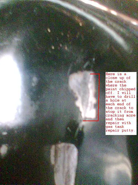

OK, I found the problem. It looks like the tank was cracked before it was painted.
You can see where my cable guides rubbed the tank, but it was not leaking there. Just above there the paint had chipped off and there was a crack under the paint that started leaking.
So, it looks like a trip to the autoparts store today for some gas tank repair putty.

take the tank to a radiator repair shop or if your careful you can solder the thing shut but you can also blow yourself up in the process. Better than tank putty.
