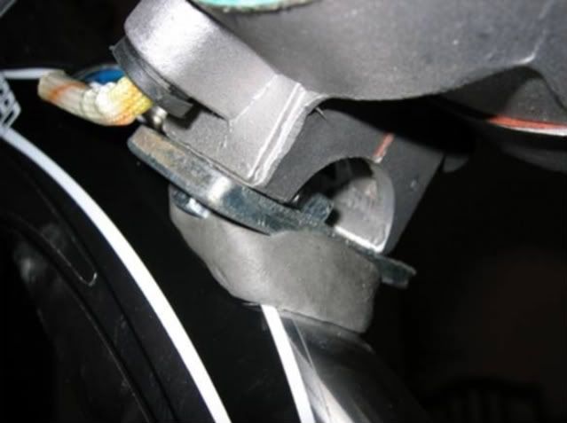

I have the Motor on the new frame and It's only on by 2 bolts and they are reinforced by cold weld stuff and I have the 3rd bolt with cold weld as well. I don't know if this will be enough to hold the motor safety but I will keep a eye on it.

I still have a Titanium Nitride Coated Drill bit and a punch as a back up in case the cold weld doesn't hold out and I need to get the snapped bolt out.
The motor is a CH80 Motor.
Here is pic of what the motor like mine looks like.

On your front or rear mount? Is this what you did?
Some dealers say it will work fine. But I don't like. I would rather drill a hole in the frame then use epoxy. You could also use a muffler clamp to avoid drilling a hole in the frame.

Are you saying the engine is mounted with three out of four of the studs/nuts? That won't work for long.
Get an EZ out and remove the broken stud, you will be happy you did.

Because the cable comes out of the housing on either end of the cable. Either on the end of the carb or the end going into the throttle.
We already tried to drill into the screw and the drill barely made a dent in it. I don't know if the bit was not strong enough or what was the case.
I can take a pic of the cable slack and how we cold welded the bike.
I do have a Center punch and that drill bit I mentioned before along with a screw extractor drill bit.

Get a brand new drill. That way you know it will be sharp. Those studs are real soft and drill really easy. And do like Norm said if you can find a bit that turns left to drill you may not even need the ease out. But they may be hard to find...........................

if you still can't get that bolt out, take the motor to a machine shop, auto shop, motorcycle shop, lawnmower shop, heck even Ace Hardware might be able to do it. Probably would only cost a few bucks. Even if they can't get it out, they ought to be able to drill out the whole thing and put in a helicoil for just a little bit more cash.
I really wouldn't trust that cold weld stuff for anything structural like this.

I guess you could try attaching a smaller diameter bolt to the broken stud with some jbweld or whatever and see if you can unscrew it like that. Just be careful to only get it on the stud, not the motor.
all else fails, keep tryin with that drill I guess.
