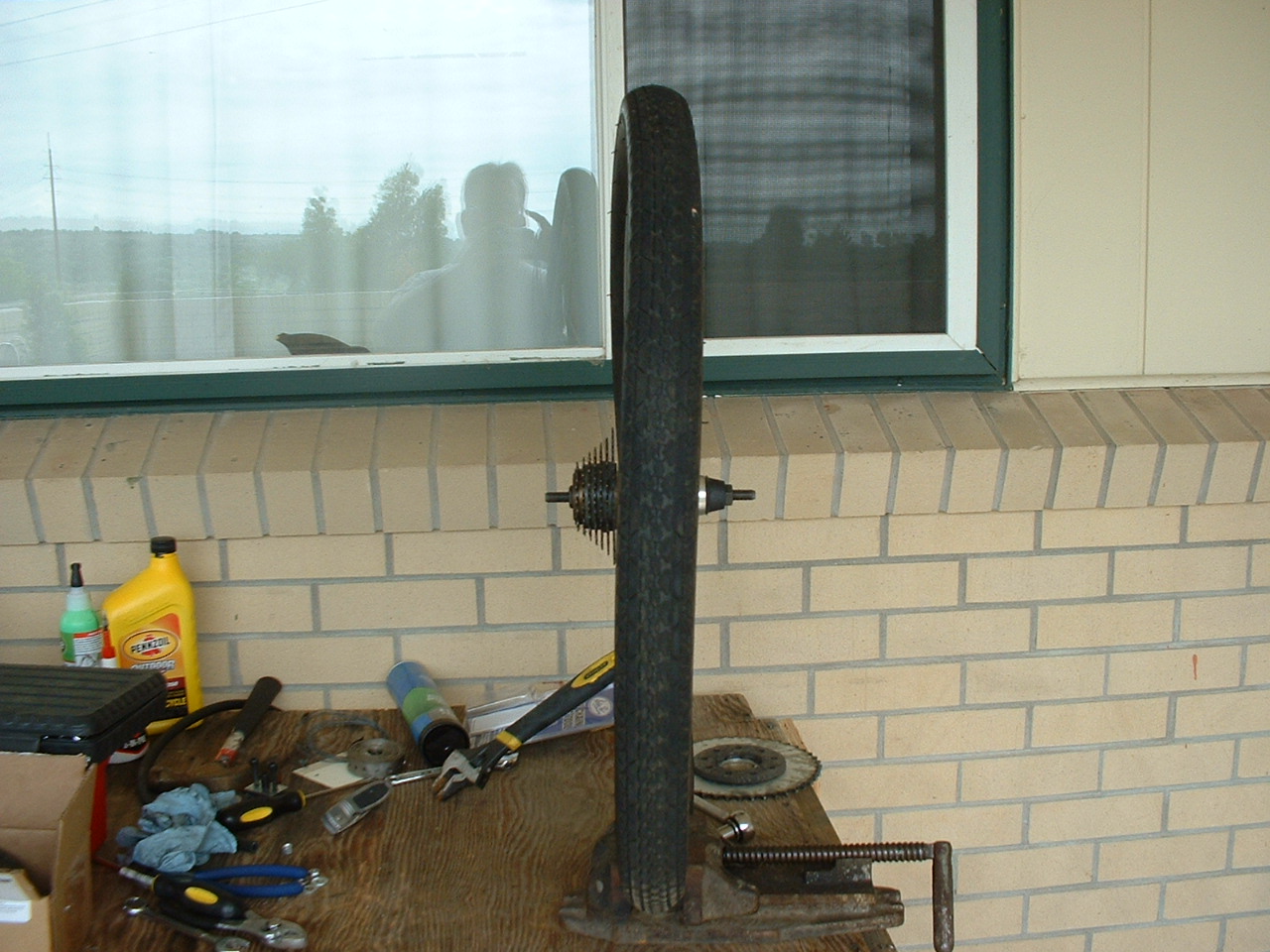

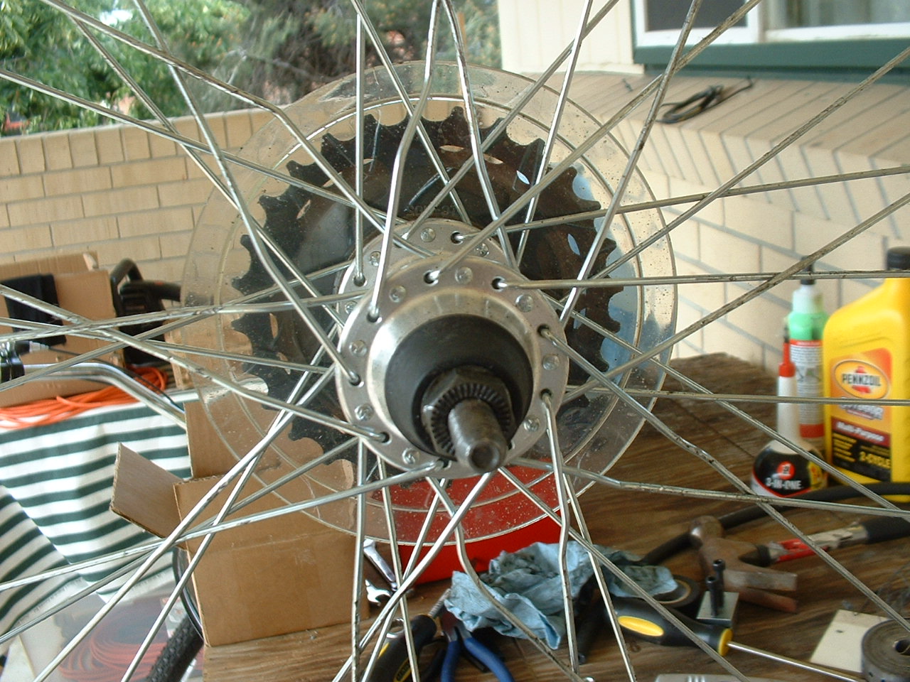

One thing I am curious about is why such severe damage was done to the spokes of the rear wheel? (See pics below) Have read in the forum that losing a chain seems to be a normal part of riding and no big deal, (As long as it doesn't take a piece of your anatomy with it when it goes!) just fix the chain and go but that is not what happened to me. I was just taking off and was only going about 5 miles an hour when it locked up the rear wheel and seriously bent the spokes and the rim. The chain jammed between the bolt on sprocket and the spokes.

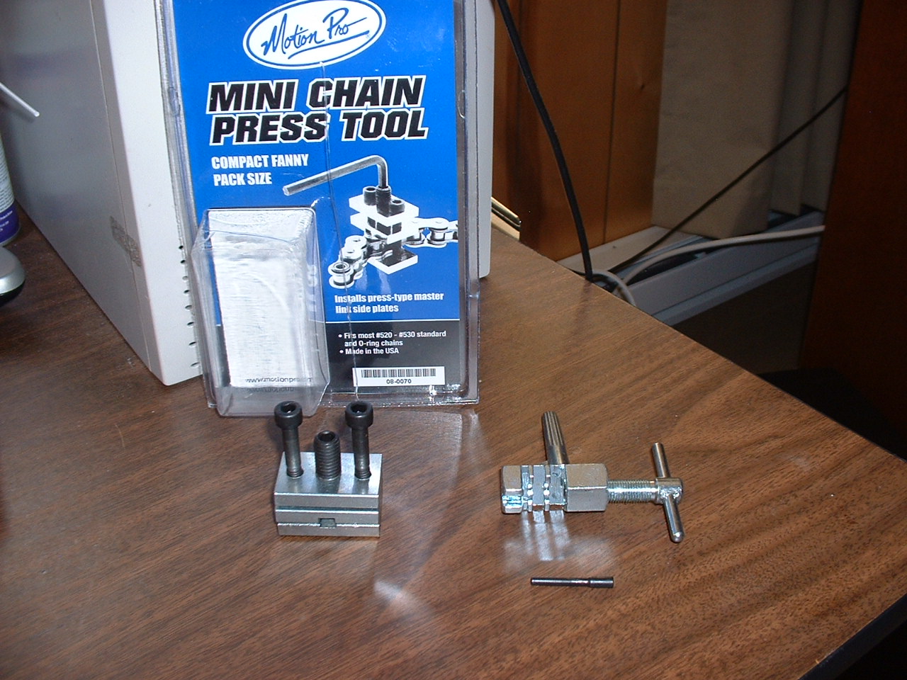

Well just wanted to post this for the benefit of other noobies in hopes it might save them a major hassle and some expense. I could be wrong (more often than not) but a master link will not be part of my bike ever again. I went to the motorcycle shop and bought the "Mini chain press tool" in the picture below for $17 and in 15 minutes I had a chain that does not have a master link. Easy, peasy, chinesy. Should have done it on the first build. You don't have to cut the chain either. Before I started the build I bought a bicycle chain tool form Wallyworld but it was to small for the kit chain. (The one on the right in the pic below) Heard you can break the tabs out of the middle and make it work but all you really need is the little pin knockerouter that came with it. A pair of vise grips and a hammer and this little pin and you can knock the pin out of the chain in a few seconds. Don't knock it all the way out if you can help it as it will make it a lot easier to press back together. Going to upgrade to the #41 chain in the future too.

Now that chain break gets a bad rap... I broke two of them before I figured out it was me not the breaker. You can not wind it to the end and put pressure on it. It just strips the threads.
I wouldn't even try it on a large chain though I broke one of them on a motor chain trying to force it out. I have one now and have used it several times on bicycle chains and it works great.
