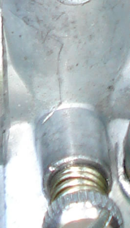

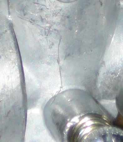

Can i use the bike with this crack?
The Engine is stalling when idling, otherwise it drives ok.
Name:	hair line 2.jpg
ID:	1100   Click image for larger version

I say "If it runs and you need it......Ride it!!". I would look into replacing that part though.

yea but it this a source of a vapor leak?

I have just one thing to say young man..... JB weld

Yes, JB Weld, RTV sealer or even some Seal-All to fix that for now....yeah, that's your air leak.

Well I am not using it today, I am already at work.
I will try to seal it up this weekend how long will JB weld hold?
I geuss I need a new carb. question of who to order from?

I'll third the JB Weld suggestion.
If the surface is nice and clean, the JB Weld should last quite some time.
You can get a new carb for $22 from Dax. Honestly though I'd look into finding a better carb for replacement....

jb weld will hold FOREVER! that is your best bet...I've already used some of that on my clutch pin cover. it gets lots of vibration and heat, and is solid as a rock!

Forever is long time, not a big fan of vapour leaks!
