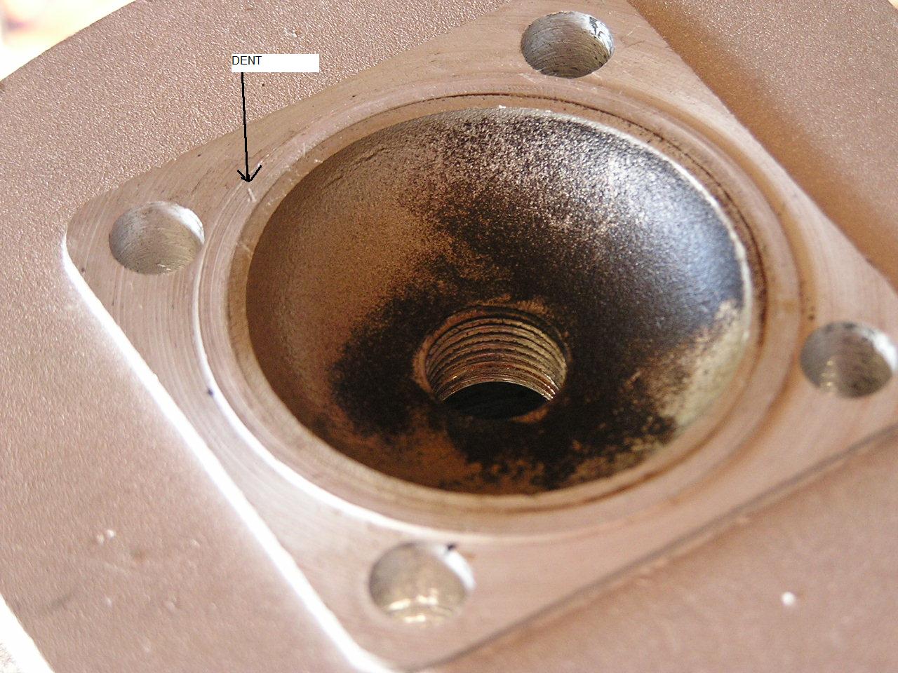

Did the Norman wet paper, water and dish soap on glass thing.
Took just a few thousands off, maybe about .005"-.008". It 's a bit hard to measure without a proper height gage. I used the butt of a caliper. I took enough material off to eliminate the small dent/gouge shown below. I had only one freak out moment - I thought I sheared a head stud - but it was a loosened stud spinning until seated. Phew.

Pretty quick and easy to lap it. I was mainly doing it to make sure it is flat and remove the factory ding - plus have some relaxation. I run a NGK B7HS
.....and it too seems perfect....I'm really wondering if anything fro B4HS-B8HS will work fine.

Originally Posted by MrLarkins View Post
i've lapped cpu blocks for better heat transfer, but what are the phycis behind lapping your cylinder head?
The physics?
1) Flatter for better seal (not that there was a problem)
2) Smoother for better seal (got rid of some Chinisesisms - see photo)
3) Slight material removal (with a slight compression ratio increase With better fuel air squish, perhaps efficiency improves a tad - as long as there is no pre-detonation.)
