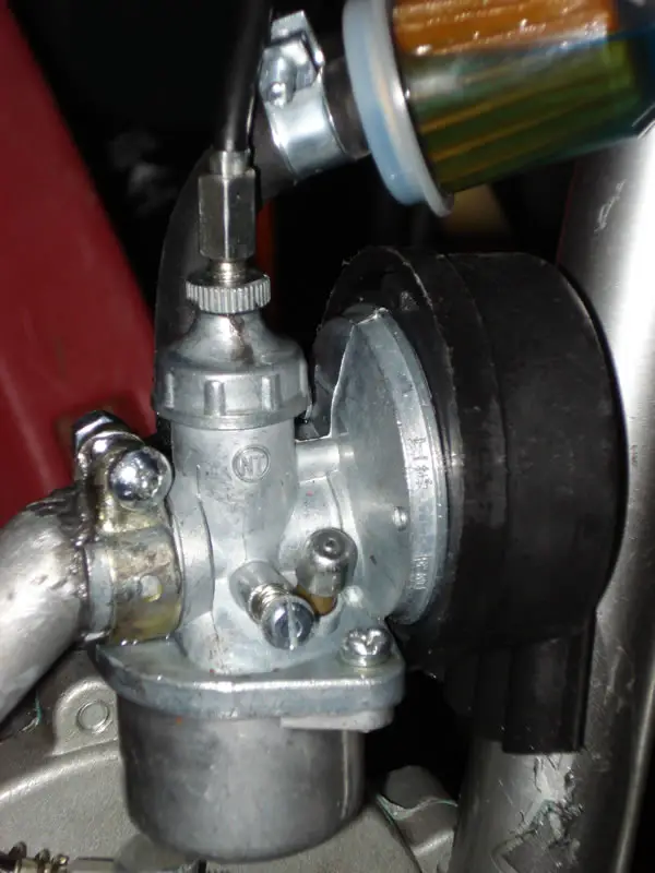

My engine was running fine but lately , The bike seems to run fine but when I come to a stop the bike stalls after several seconds, It starts with very little effort as well. I had done over two hundred miles so far with only the regular problems.
I noticed that I had a gas around the bowl of the carburetor and leaking out of the air filter.
I cleaned the carb twice put on new seals. sealed up the carb as per Norms instructions the e-clip on the needle was already on the second slot from the top, new gas filter, Put in a champion spark plug, set the gap, AND NO MORE GAS LEAK!
I started it and spayed WD40 on the intake and the joint the joins the two peaces together and NO vapor leak!
Last night I rode it for a while and when, I stopped the idle was low and sounded like it was going to stall, I turned the idle screw in it made the idle higher drove it again but it stated to idle low again, so them I moved the adjuster on top of the carb (holding the slide up) test drove again and adjusted the idle this seemed to help.
Tested a little more it still seemed ok, Checked on more time with WD40 for vapor leaks everything was still good.
Started this morning, the engine was racing moved the adjuster on top of the carb down and it seemed ok , Checked for a vapor leak again and no leak, decide to ride to work, the idle stared to get low again so moved the adjuster on top of the carb up.
Rode the rest of the way to work seems to run ok put the idle problem persists
Any Ideas, maybe I have too much slack in the cable?
Or the jet still has something in it?
I am really puzzled and woried about running lean. on the Old plug the gap was too small, ( I never checked it because the engine was running fine) was oily but I think that is normal during break in.

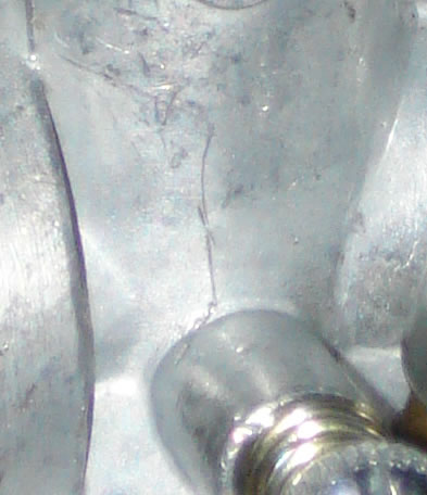

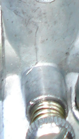

i found the real souce of my problem (I hope!!!!)
I found a hairline crack near the idle screw I will try to seal it up with some JB Weld.

I agree with Joe you need to really look for the source of the leak but it sounds like you have a vapour leak.
I suspected that, I had one but could not find it, I only fou nd when i was examining some photos I took of the carb examining the idle adjust screw!
