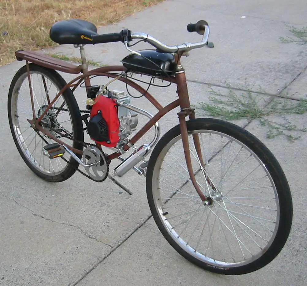

Hi Guys, thanks for the comments. I still want as much more info as possible. Due to some of the responses here, I have learned a couple of interesting things.
#1 the little clones, though nice (I have one), are rated 1.5 hp
#2 The Honda (more money, tho well made) is rated 2.5!!!!
IMHO an increase of .5 hp is major for what we are doing, wouldn't people here pay good money for a carb, or a pipe that would deliver .5 HP?
I'm excited, a full horse is an amazing bonus! Soooo... this morning I ordered a gx50 from small engine warehouse. I have a grube gearbox from an earlier deal, and I have this little bike (see pic below). I think I have put on a front brake, if not, I surely will.
This little bike did a solid 30mpg, with JL gearbox, and the 1.5 Hua Sheng. I had set it up with the 44, which will not be appropriate for the Grube box? I always pedaled off the start, but when I let people test ride her it seems they NEVER did, tho I had told them to! It did, however, croak VERY early, some sort of a GB failure.
I am not up to date on the mix in the gearbox, for the JL the mix that had worked best was, packed with pale yellow Hi-Temp Disk brake grease (automotive), and then, when she started chattering, I found that if I mixed some SAE 40wt with the DBG, it would licquify into a very nice slurry which would continue to melt down, and continually lube the clutch, without bubbling out of the vented bolt at the rear of the box like the stinky 90/140 Hypoid did.
My goal is NOT to do the Grube box as a final, but to compare the H-S with the JL, to the Honda with the Grube box.
I know about searching, but since this thread is about the 4-stroke, and I'm adding (temp only) the grube, how would you guys suggust to set it up?
I probably have a 50th sprocket around here, but never had a larger one, and I can still make the same mix?

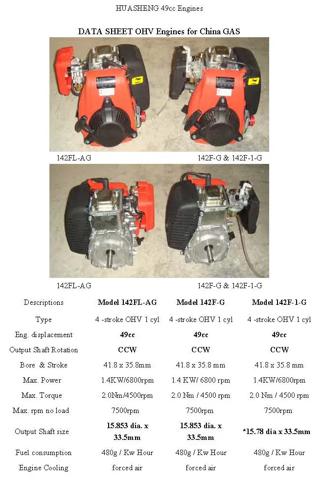

Here are the specs for the Hua Sheng FGs to compare against the Honda GXH50cc

The HS and Titan XC are EPA and CARB II 2008 Compliant. Honda rates their motors at 1.8kw and HS are rated at 1.4KW. Both Honda and HS are IC motors. Industrial Commercial. They are manufactured for Commercial Industrial applications and are both very reliable. From my Testing experience over the decades, I can tell you for a Fact that Honda HP ratings are accurate to the T. American Engines such as Kohler and Onan were always under rated with no exceptions. There were times where I would put double the KW load on Onans and Kohler enignes before they would start to load up. Onan and Kohler were and still are the Industry standard for IC usage. Still are. Not Honda , Titan, or HS or any Asian motor was ever considered the standard of the Industry. It was always American Onan with Kohler a close Second. Cryco also produced some super IC motors with big cubes and with a turbo and hydraulic governor produced some huge numbers at very high altitudes and pressures. Honda was always the cheaper and weaker motor of choice. As was Kawasaki. The Asian motors such as Hondas and Kaw ran a high 3600 rpm governed IC usage. Onan and Kohler were 1,800 rpm. I sold a lot of both. The Onan and Kohlers were much more expensive than the Aisan versions if you can call them that. The asian versions were designed to accomplish the same job but with a different engine rpm. . I have not checked the past few years to see if Honda pricing has moved up closer . I can tell you this. It used to be that Honda was good and cheap. Now it seems as though Honda is still good but not cheap anymore. I just bought a piston and ring for my Honda CR250. It set me back almost 200usd. No kidding. A front Rotor for my Honda V65 is over 200usd. Just for a Rotor !!! A Rotor for my Harley is 65usd. What has happened to Honda? I also bought 2 tank bolts for my honda. 2usd a bolt ? what the? I told the Honda guy this must be 400 percent mark up !! At any rate. Out of protest, I may get out of the Honda business. I still have my Honda V65 Sabre with Honda line. I may keep it. I may sell it and buy a BMW K100. I love the wicked power of the Sabre. At any rate.. That is what I know from Decades of engine service, building, testing, engineering, manufacturing, and selling at low and very high altitudes. Man..I am getting old.. lol.. Enjoy the ride..
