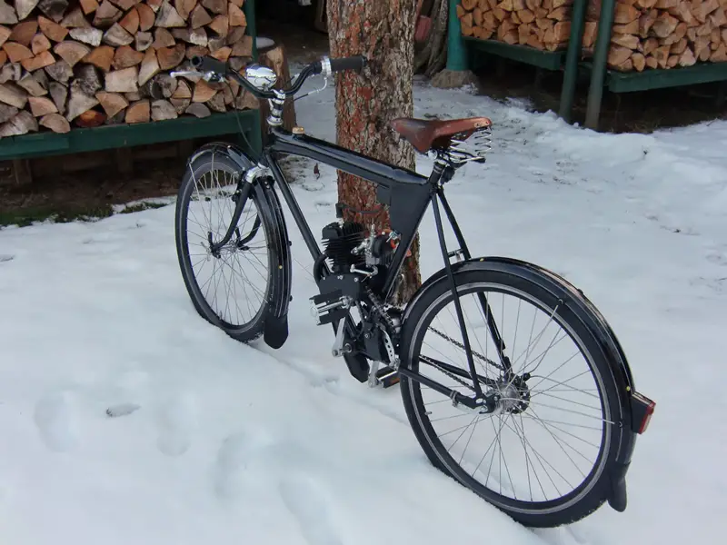

Hi my name is Harry and I come from Germany.
Im 23 years old and my english is not the best ... so i dont know all technical words but i hope you understand me.

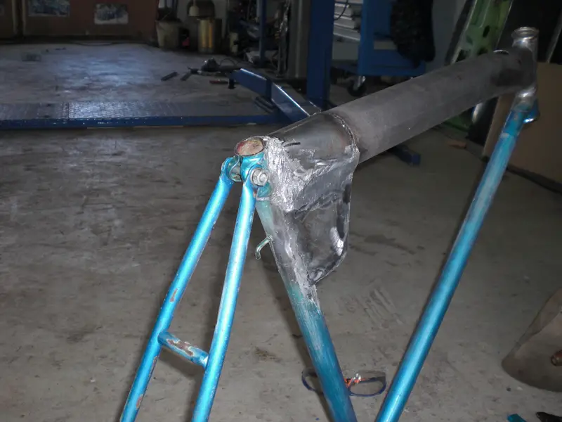

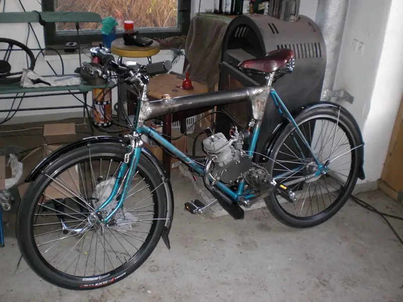

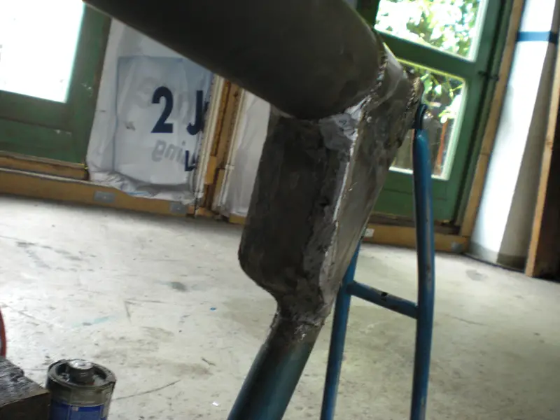

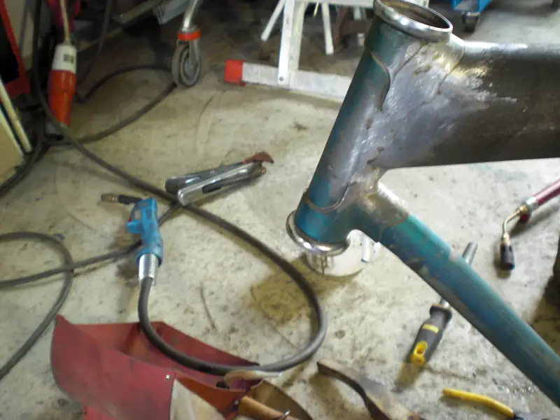

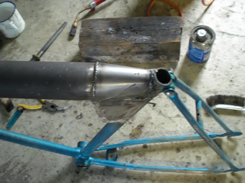

I build that bike in last winter. I bought the engine in Ebay USA and the seller send me the 70 or 67 ccm engine . So i started with my body work as you can see on the first 4 pictures... the tank has an capacety of 1,6 liter... so i can go 6o kilometers.

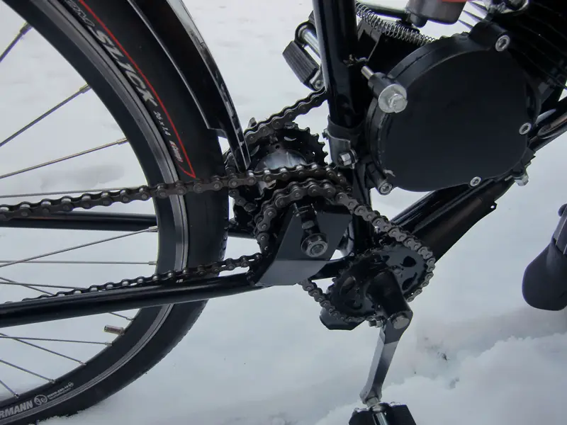

Body work done. Than i put all parts together .. Not so easy because i constructed my own transmission as you can see later. I can choose between 3 gears for the engine and 3 gears for pedaling. So it needs a lot of fine adjustmet unti all chains run and dont jump down anymore... So i did my first Test run BUT...

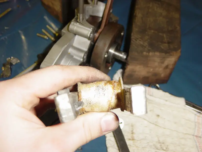

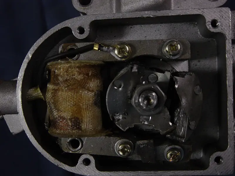

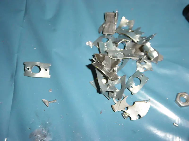

BUT ! After 5 metes the engine started and after 10 meters it blows up... Dont know the reason exactly... I think the magneto didnt run round and jammed. than it made some terrible noise and the test drive was over... I had to buy a lot of spare parts and wait a long time untill they arrived in germany... Put all Parts together... No before i have to say something! As i decomposed the engine i wonderd how that could run ... i have never seen such cheep prodused engines before... very funny You see that rust on the picture? ...
So i put all together and made some testrides... ca 250 kilometers... runs great. top speed in 1 gear is 35 km/h in 2 gear 45km/h and in 3 gear 55 km/h with some wind from behind may 60 km/h .
I tested it with an bike computer. And it runs great

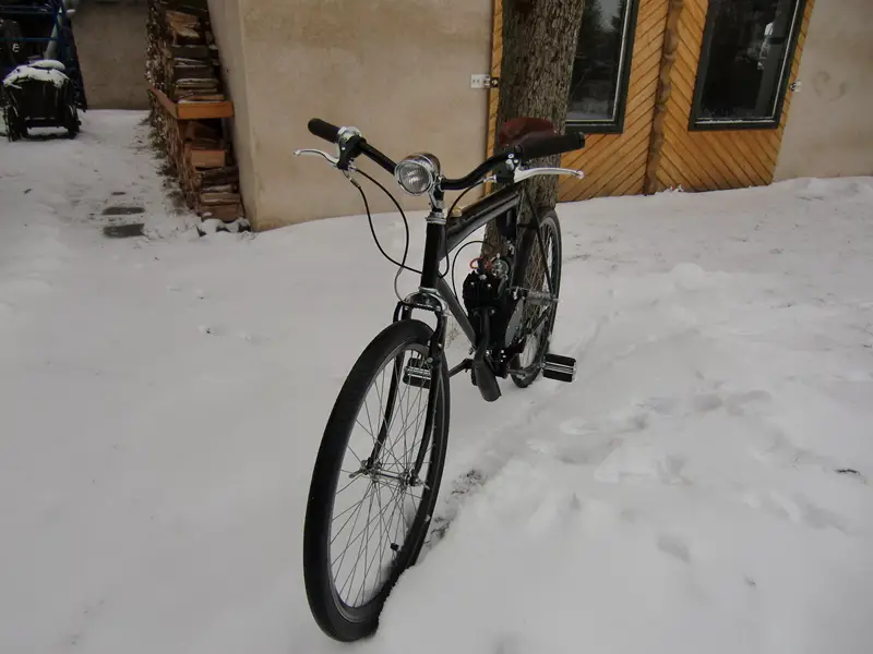

than i disassambled all parts and painted it black... also the engin with heat paint... I build another exhaust that fits better and makes a better noise
Now you see the pictures after assambling. First Pictures without Fenders

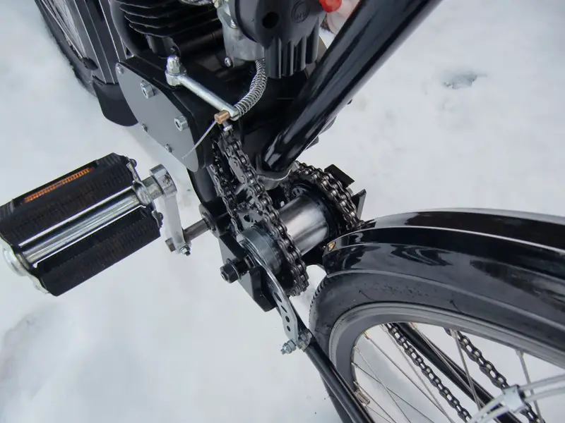

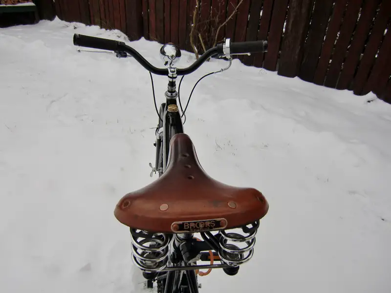

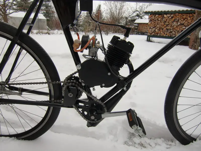

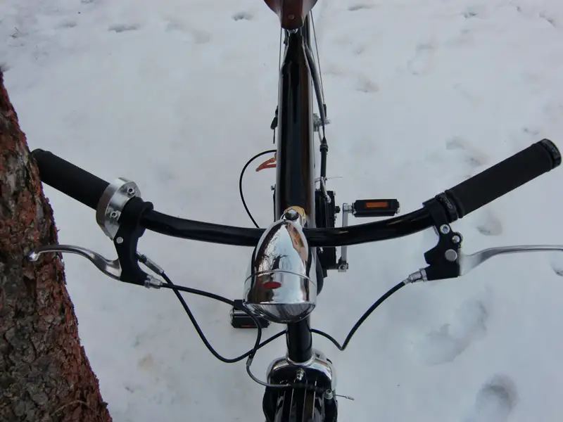

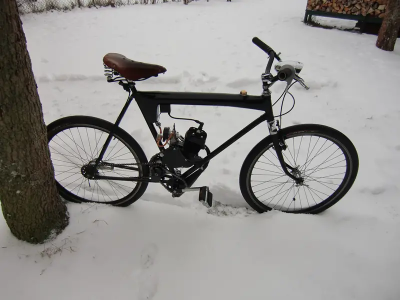

Now the pictures with Fenders . I think it looks a bit more oldsql But i wount drive because everyvere here is snow and rain it is so nice clean now... , but the sprin will come.
Some Facts:
- Frame: 26 " Diamant frame from the 70īs produced in german democratic republic.
- Brake: only one V brake know but a disc brake is planed...
- Engine: 70 ccm china
- Tank: 1.6 liter self made
- Transmission: 2 switching hubs with each 3 gears ... these 2 hubs make it possible to pedal without motor turning and to roll without pedals turning... Very complycated self construction.
-Top speed 55: - 60 km/h that are ca 35-37 mp/h
Nearly all parts are new or worked up. It looks like new.
i want to sell it. What do you think about that bike and what can i take for it ?
thanks Harry

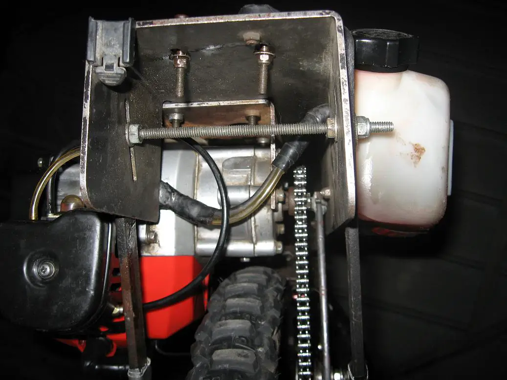

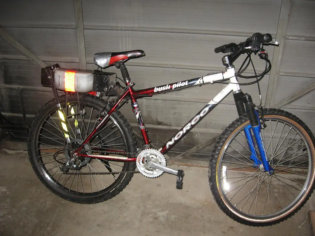

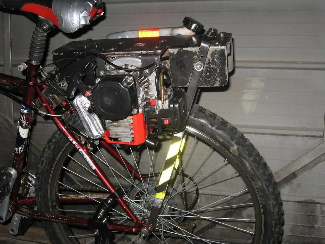

Hello Harry from Edmonton Alberta Canada. I like your pictures. This is what I ride in the winter. The motor itself is very tough . I really pushed this tiny little motor and it got me through 2 winters already I was told that company who makes it is owned by MITSUbishi. I am not surprised because it really hauls.
The motor alone is over $200.oo (35cc)_

Harry , i really like the way you did your transmition setup .
Did you use Sturmy Archer hubs ?

@Blankenstein : Hi. So. It looks very... ahm ... solid but i think it will bring you through the winter .
@ diceman2004 : Hi, no it are not stormy archer hubs... the hubs are from shimano and sachs, but the technice is nearly the same. (from old wimen bicycles) And the bowden cable with the hand circuit goes up under the saddle. ther is the small switch.
@AllenWrench: good german ! I bought the engine from "boygofast" and i think it was just my luck . **** happens. but he was friendly and i dident had to pay full price for the spare parts i needed. but if he would have tested the engine before selling it the trouble would have been spared me.
@ all: what do you think. How much is it worth? if i would sell it. i have seen some bikes from "derringer" or so... ok they may are a bit more high quality but how much do that bikes cost ? I mean are there people out there how would buy such bikes?
