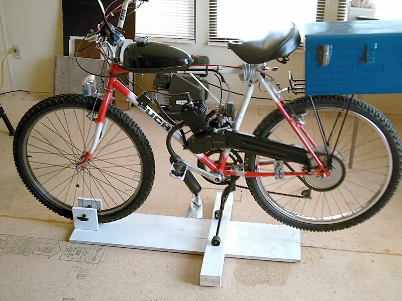

Well; It was a rather miserable winter here in the S.E. corner of the national mitten, So I had
A LOT of time to putz around & piss off the wife. First off, I came down with a NASTY case of
cabin fever around the end of January so, while the wife was at work, I ripped up the carpet
in the spare bedroom & turned it into a workshop & bike garage. I bought some new tires for

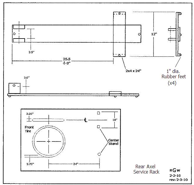

the bike and found it a MAJOR pain in the keister to change out the rear. Most of these bikes with center stands (like mine) are rear heavy. I decided to design a service stand that would hold the front end DOWN so I could freely spin the wheel while oiling the chains or remove it altogether. Pics are attached. Feel free to use them as you wish.
Rob (crzyolphart)
