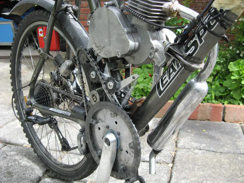

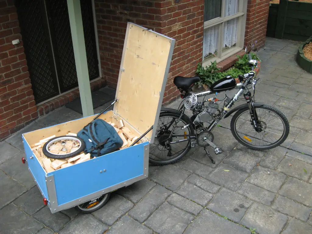

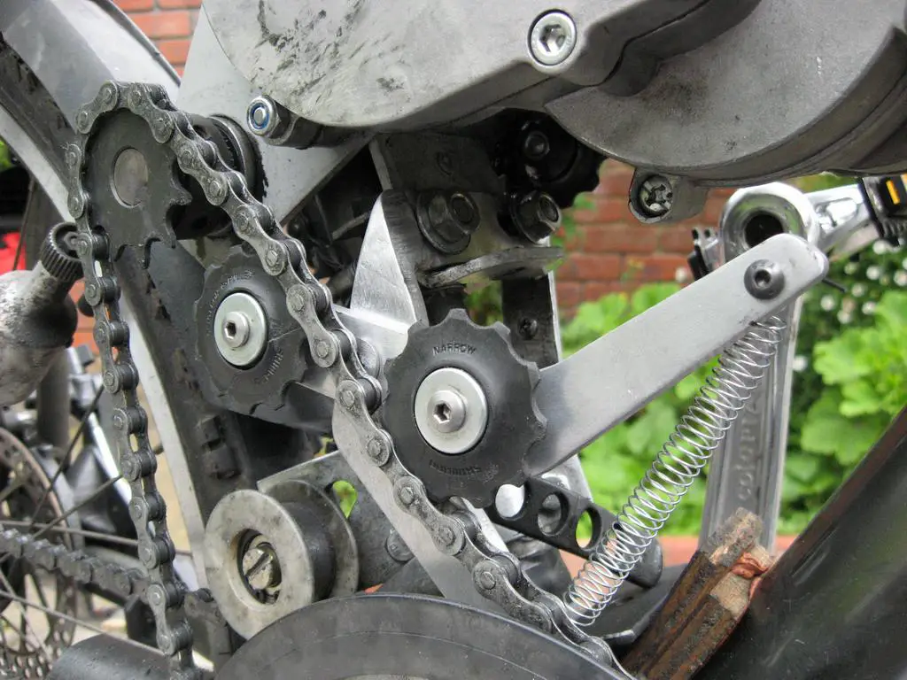

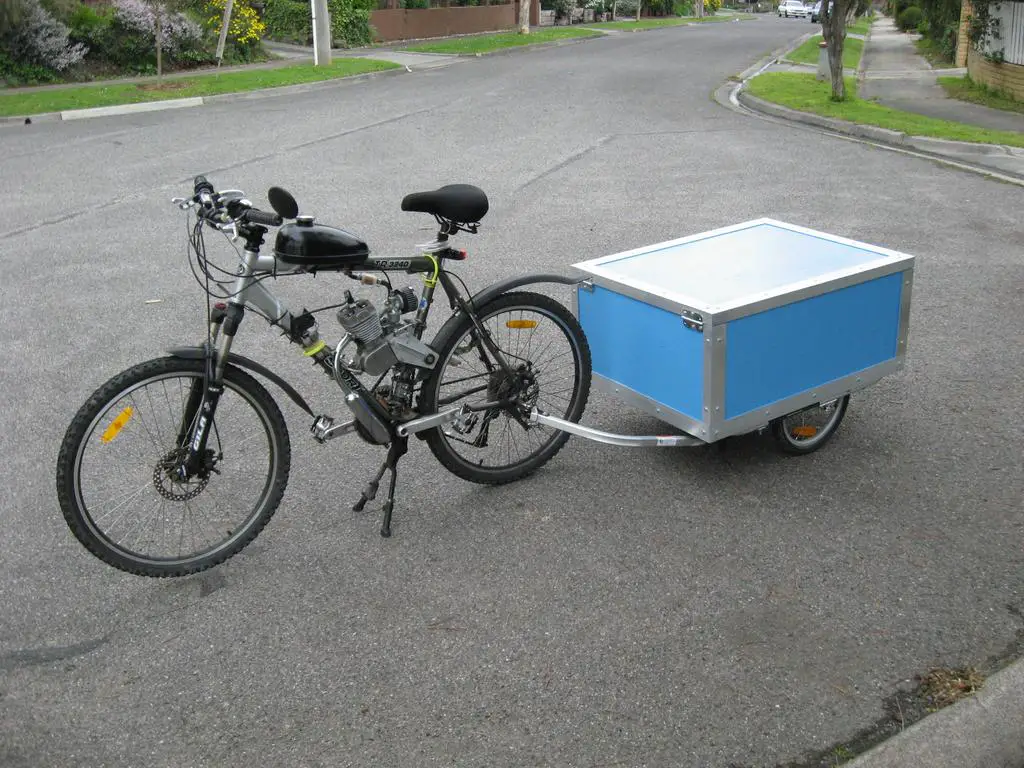

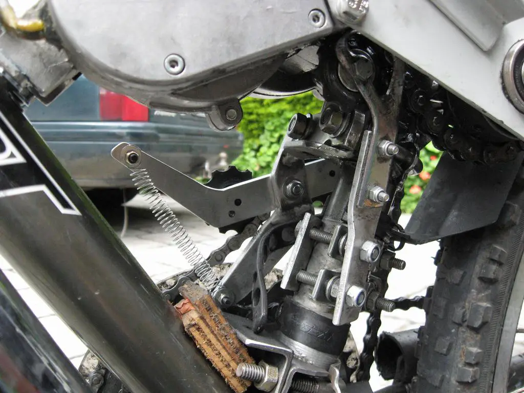

Hi lreeves
If you have any doubts about the SickBikeparts shift kit,,, they are completely unfounded.
I have now travelled over 5,000 kilometers (3,000 miles) on my shift kit and the one way bearing is still running like brand new, and i've never even oiled the thing in it's life (ok, maybe the black filthy sludge and goo that drips off the 2-stroke engine in great quantity has lubricated it somewhat).
I have a trailer setup that weighs 35 kilos (77 lbs) with the stuff i generally carry and approx 65 kilos fully loaded (143 lbs).
It's a good idea to get the SickBikeParts optional 30 tooth dished sprocket which attaches to the standard 36 tooth sprocket to give a super low hill climbing ratio if serious hill climbing ability is required.
If you need more even more pulling power, get the optional 48 tooth chainwheel and the optional 9 tooth jackshaft sprocket - with that combination and the new 9 speed Shimano 12-36T rear cassette, you will be able to pull 100 kilos (220 lbs) of cargo that makes you money in the bike courier business.
Just get the SickBikeParts shift kit and be done with it - you'll thank yourself.
Pics of my setup below.
