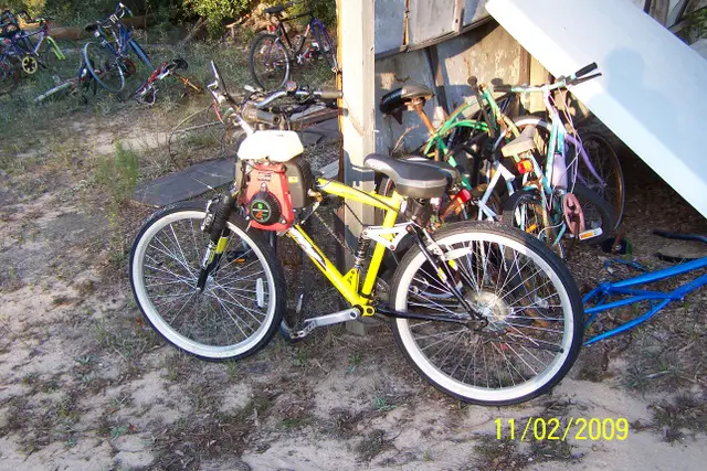

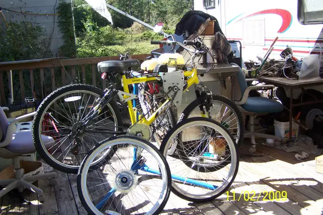

Mo, 2 Gears Is Better Than One, 3 Is Better Than 2. I Really Enjoy My 6 Speed With Sbp Shifter Parts. I Don`t Use 6 Gear Much Because Then My Chains Rub Each Other. Pablo Or Ghost At Sbp Can Help You With The Crank Sprockets Best For Your Build. The Stuff Can Always Be Transfered To Another Bike. Bikes Are So Cheap On Craigslist, A Lot Of Good Buys. Ron .
