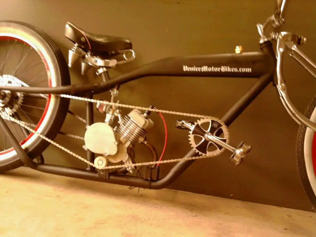

Look at the thread of this bike I built... I did it all without welding.
I'm sure you could do something similar.
