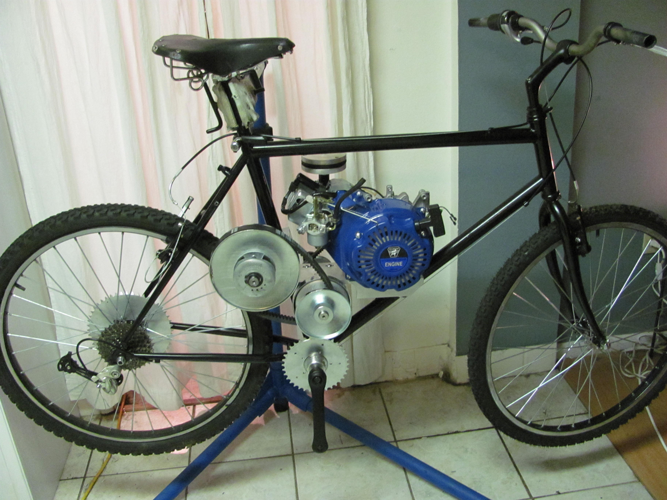

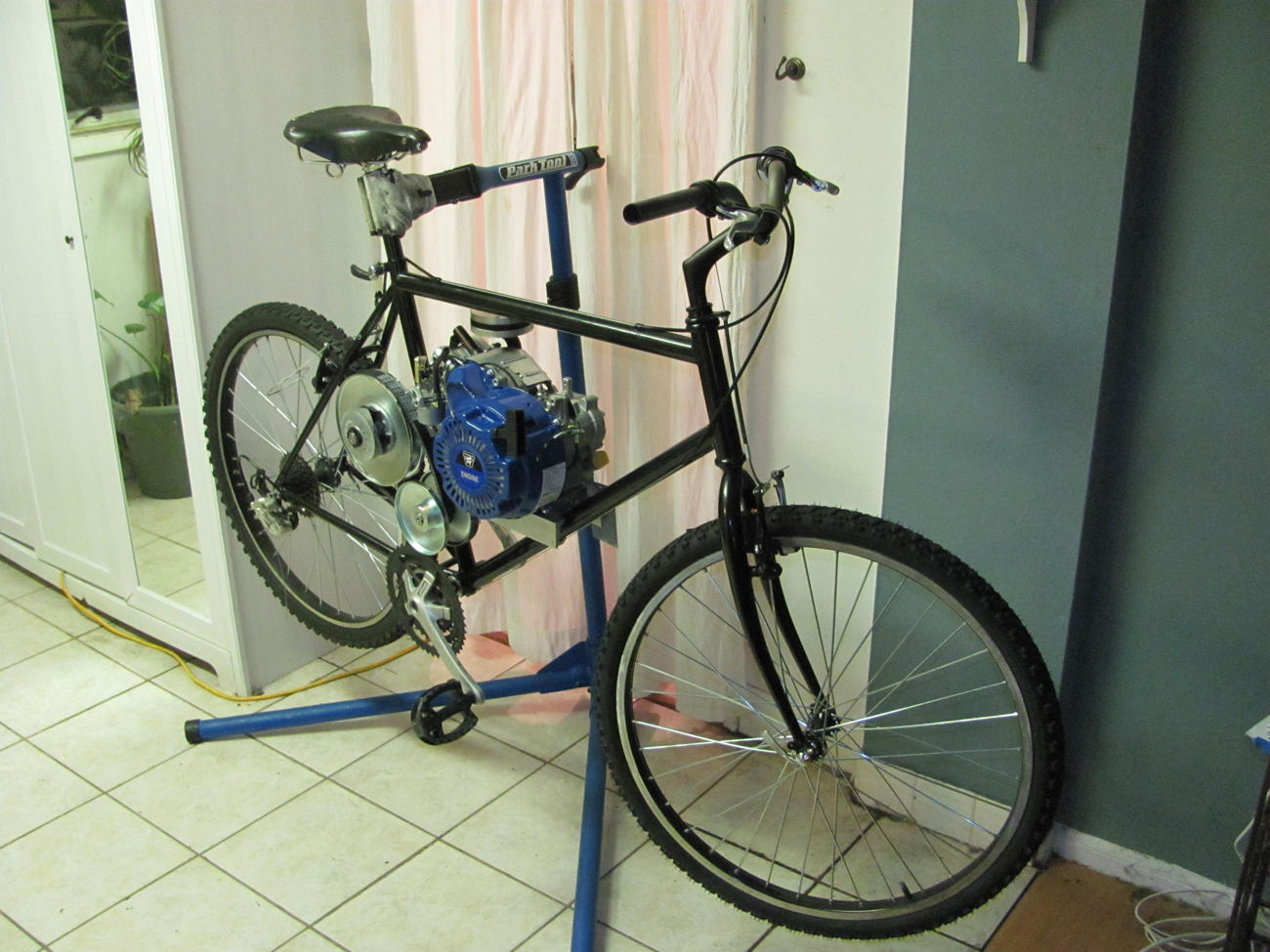

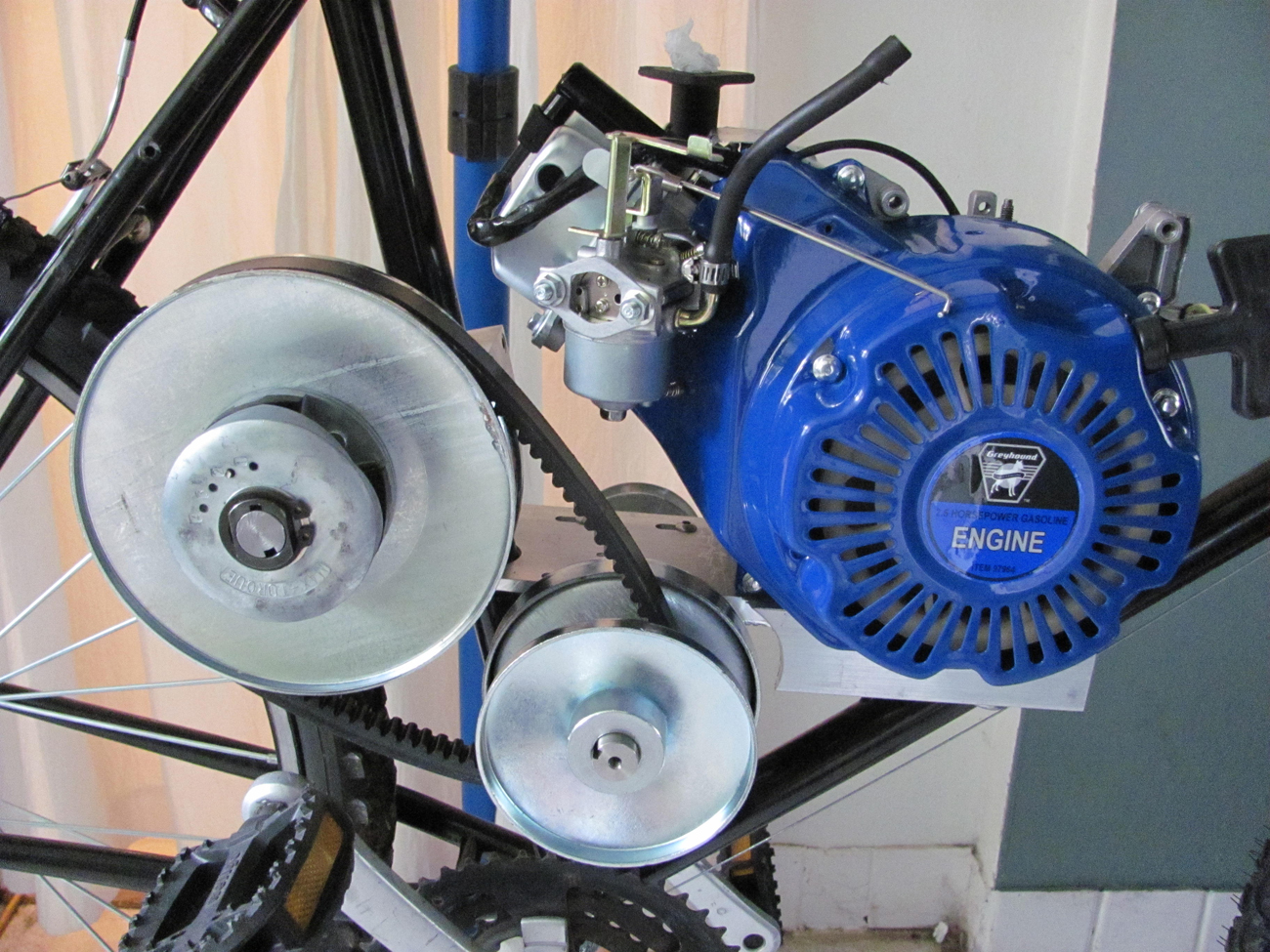

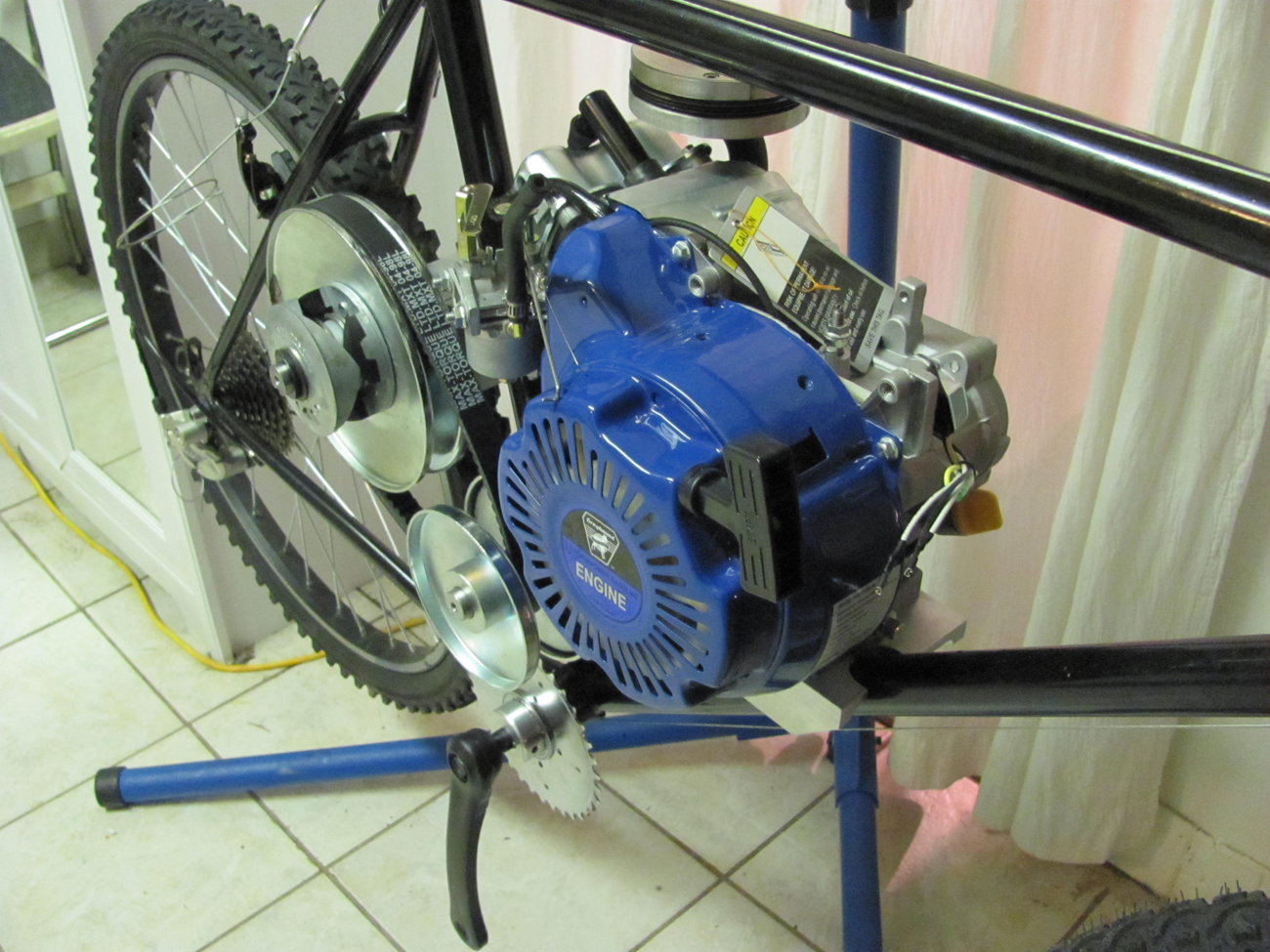

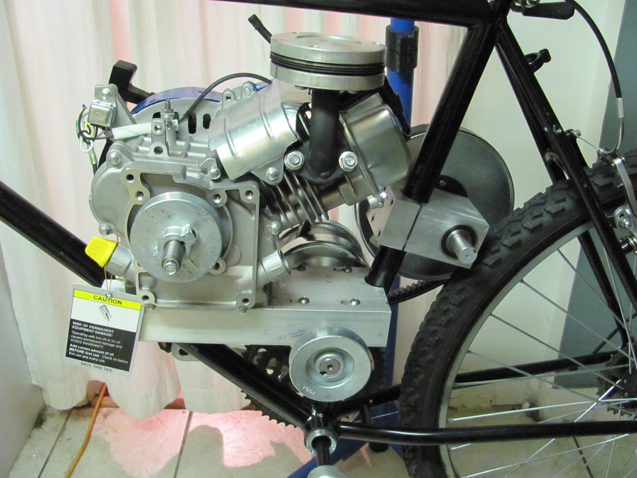

Just noticed the new MTB/Road, Cruiser etc boards to post on! Cool!
So I'm buildin' sum'm I can't wait to ride!

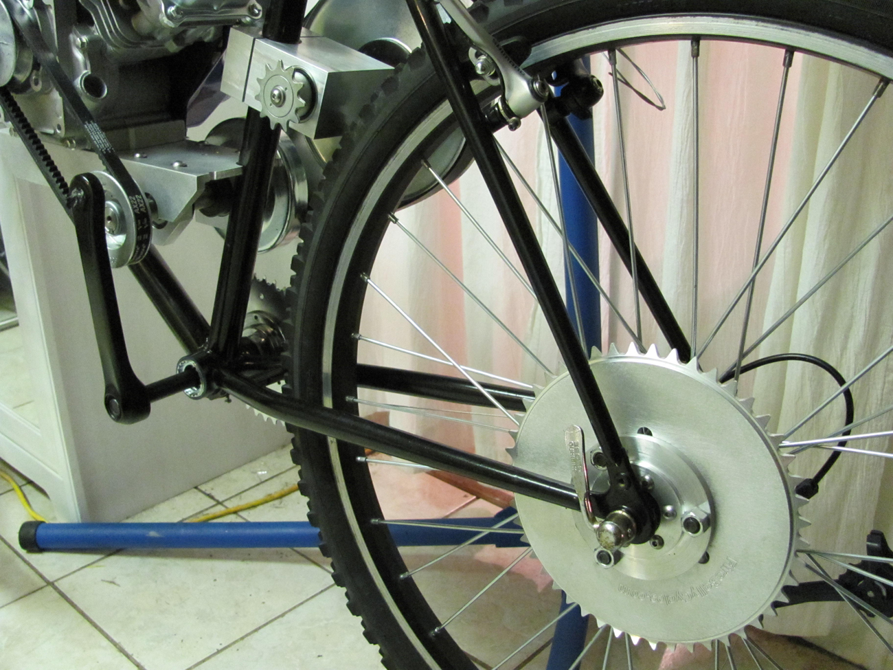

Heavy Duty Everything! Wheels Deore w/ 11g and double wall aluminum rims. FBC Engine mount (not finished, will bevel ends); the driven pulley bearing carrier will be beveled as well. No idlers necessary as both are adjustable center to center.
I anticipate wheelie poppin' low end and road racin' top. Wheel see! Wish me luck! Test rides Tues hopefully.

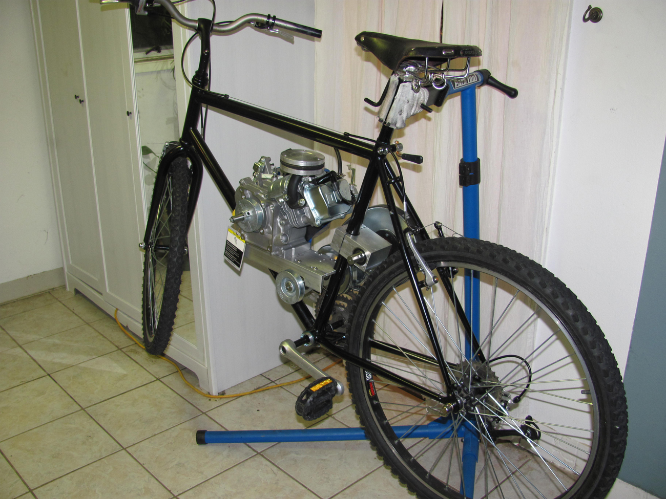

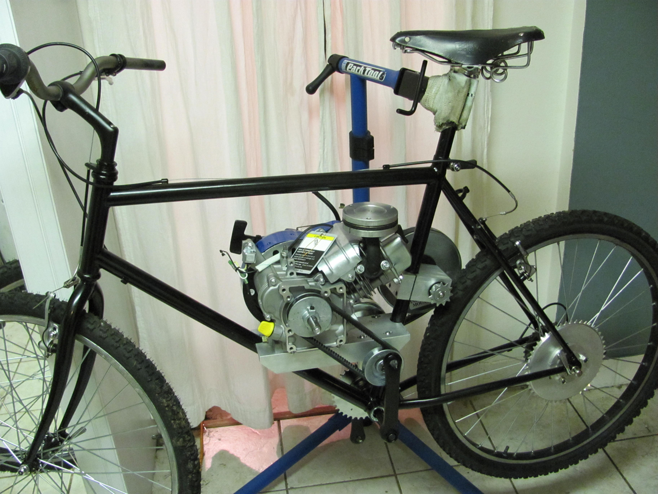

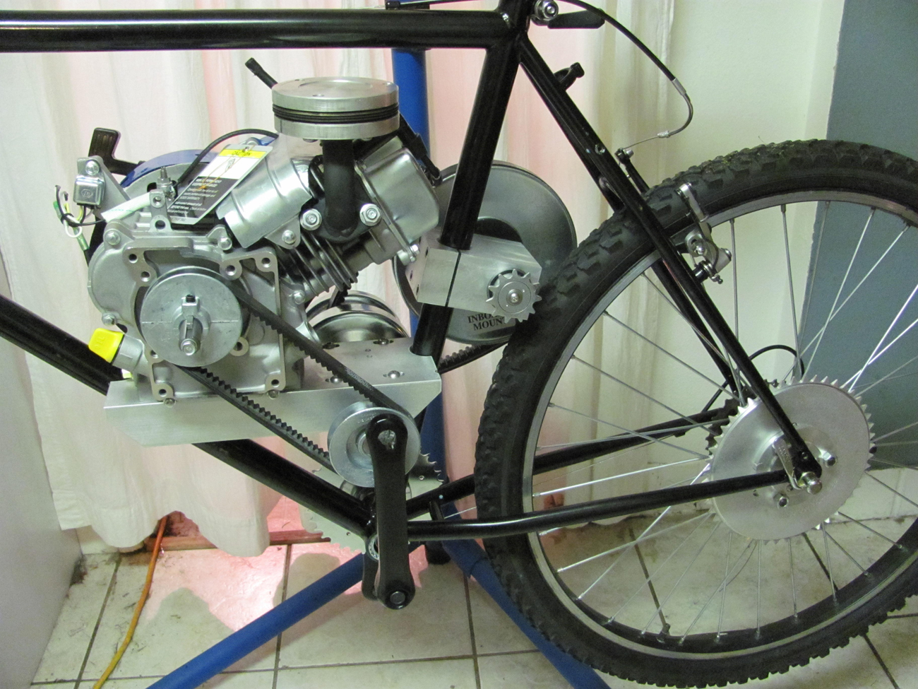

More pics! Should be riding this wknd (pls)!

wow...im antisipating allot of low end....(cant spell multisylable words).....tell us how it goes...oh watch you shoe laces and pant legs on those belts....good luck

tell us how that cvt works out....kinda reminds me of those jr drag cars....way cool...how many rpms is that clutch set for and when does the rear pulley open all the way up...im interested

Thanks for the comps and the wow's (Words of Warning)! There'll be some guards of some sort but when your motorin' don't press your ham or dangle the fruit basket into spinning parts! Basically pedal assist is going to be completely voluntary so when motoring I think I'll find the most comfortable and safe position.
The clutch, I believe is set to start engagement at 1850 and the driven is adjustable to 4 different settings of bias toward low or hi speed.
I get a "hypathetical" top speed of 27mph in Lo and an equally, but for completely different reasons, "hypathetical" top speed of 64mph in Hi.
That said my one spd HF is 1.8:1 at the GB and 5.3:1 FinalDrive. This is 3.3-1.4:1 GB and 5.3:1 FD. So it is way lower and significantly taller than my 40mph single speed.
P.S. Should test today or tomorrow pics and hopefully (if it doesn't blow up, haha) vids!
Good Lookin' Out! Thanks, Evan

If you left the governor on, you are not likely to wreck anything. I have the same engine and it is a sweetheart. No a powerhouse but nice.
