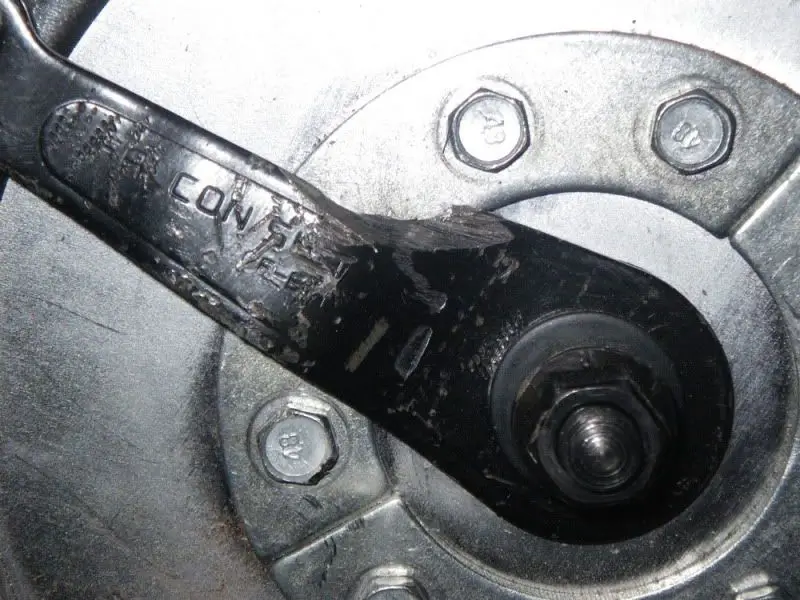

I see that you have the Falcon hub.
You may want to upgrade to the Shimano CB-110 hub
This is what happened to my Falcon hub after about 10 miles of easy riding.
http://motorbicycling.com/f3/falcon-...hub-13163.html
