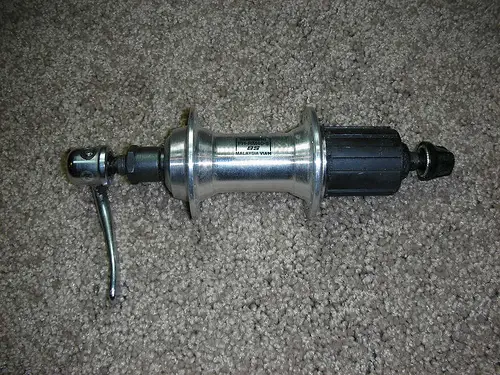

I'm having problems installing the rear sprocket flush onto the hub.When I put the black washer piece inside the spokes and one on the outside of the spokes there isn't enough room for the sprocket to seat onto the hub even when tightened down.
The hub is a Shimano FH-201 Here's a close photo of the hub itself.
What are my options to getting the sprocket centered straight onto the hub?

Have you tightened it down yet? There may be more room than you think. Once you get everything snugged up, the sprocket may seat nicely enough.
If it remains an issue, get a hub adapter and forget all about the rag joint.

Yes the sprocket does not seat onto the hub with the dampeners in place.
I've called Manic to see about the adapter but they won't answer any of my calls..I can't waste anymore $ My best option as of right now is to pitch everything in a dumpster and be done

The sprocket doesn't have to be touching the hub to work properly. It just needs to be centered. Sure, it would be a lot easier to center if it did touch the hub, but that doesn't matter. The rag joint turns the wheel by grabbing the spokes, not by grabbing the hub. I'd have to go look, but I'm pretty sure the center hole in my sprocket is way bigger than the hub.
Put it on, tighten it down a little at a time, slowly, check it for center often by spinning the wheel while holding the axle and looking at the sprocket's edge. If it's off center, you'll see the sprocket moving up and down as it spins. Nudge it back on center while eyeballing the center hole around the hub. You might be able to use a screwdriver as a pry bar there between the hub and sprocket to move it just a bit. If you check it for true and it wobbles, you know you need to tighten bolts on one side of the joint.
Lather, rinse, repeat. It'll work.
