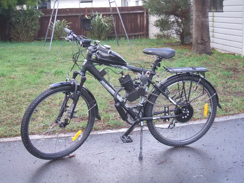

Oh well, plan B, I bought a GT Aggressor MTB and am in the process of fitting the engine to that. I’ve been at it for 8 days so far (only a couple of hours a day mostly) and am thoroughly enjoying myself. Lots of problems along the way, but that’s half of the fun - coming up with the solutions. The main issue I’ve got is fitting the carb into a space that’s too small for it – I should’ve bought a bike with a bigger frame. Never mind I’ll get there. I’ve been taking photos as I’ve been going to put up here, so I’ll do a proper write up with pics when it’s done. I just thought I’d hop on and let you know I’ve been reading your words of wisdom, and thanks for all the great posts.
In the meantime, here’s a pic of where I’m at so far …

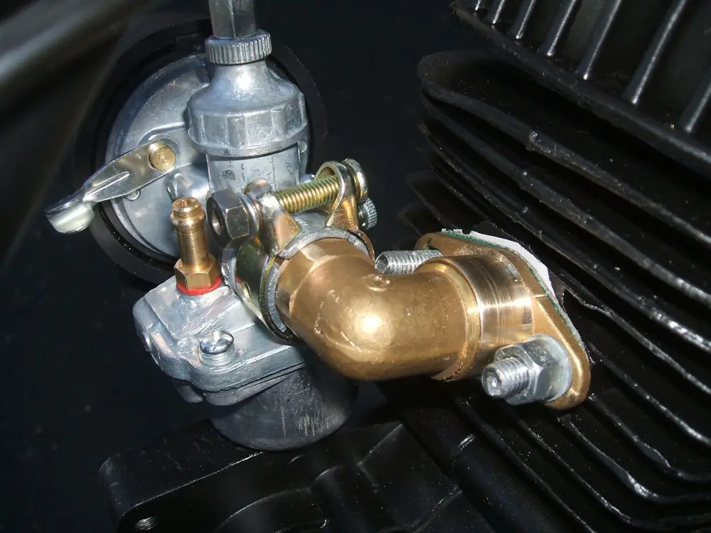

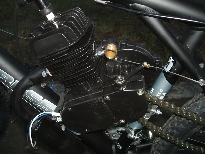

Thanks guys. I've got a few ideas to try that I got from here. My 1st attempt was to modify a couple of brass plumbing fittings which was perfect ... until I refitted the front sprocket cover and found the clutch actuating arm and nut fouled the carb float bowl. I have a length of car heater hose and a copper 90deg plumbing fitting to play with next.
Here's a pic of the fitting I made, with the carb on and a pic with the sprocket cover on, but no carb.

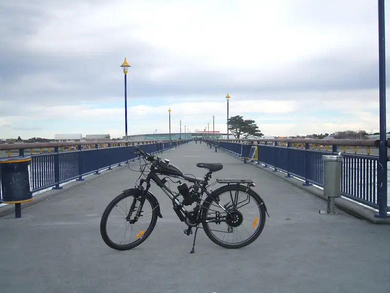

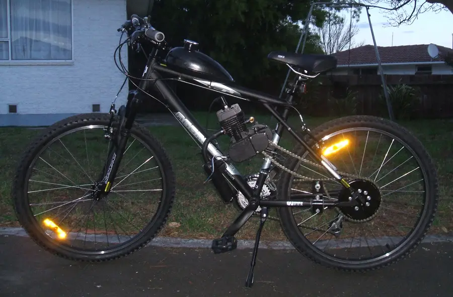

I was out for a ride today and it occurred to me that I never put a post on here showing the completion of the bike. The 1st pic is when it was 1st completed last year 2nd pic is a week or so later taken from the end of a pier looking back to shore - I got a few funny looks riding down the pier and back and the 3rd pic was taken today
I've acquired an angle grinder and a mig welder since I built that bike and have been thinking maybe I might build something a little more radical like a chopper perhaps? Dunno, just a thought at this stage?
