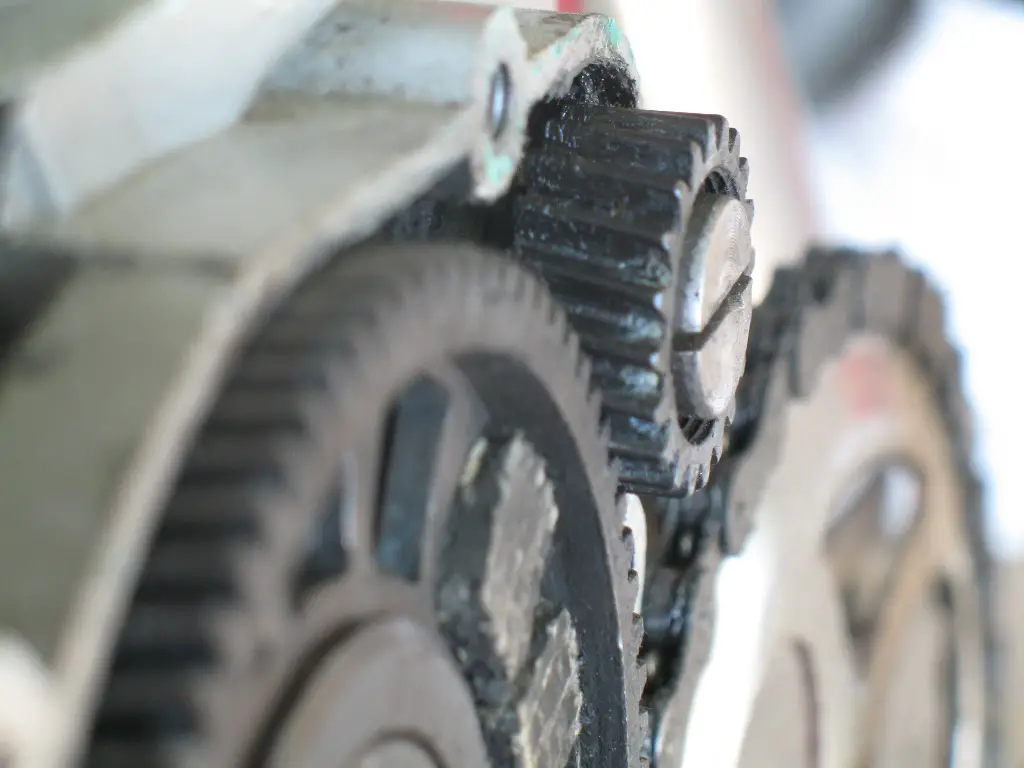

Buzzing down a deserted main st at 3AM, I lost all thrust but engine noise was about the same but free-wheeling like whine. Took clutch cover off and the small, drive gear seemed to have moved out and away from the engine and towards the pedal and could be turned by hand. Next day for the life of me I could not get the motor apart. Any advice on getting nut under spring to turn? took off plate on other side and used 2 wrenches but was close to rounding both nuts. Will try penetrating oil tomorrow, but not sure that's a great idea. I tapped small gear back inward with rubber mallet and bike started and ran a few feet then same no go, no bad sounds. (Not all bad)

You have a woodruff key problem. It can fall out or shear off.
It is easy to fix.
This thread shows how
http://motorbicycling.com/f4/bicycle...lutch-222.html

Let Rufus know a party pack/feline gift basket filled with tuna, canned chicken (cats really do love canned chicken. They are strange 4 legged folks) and some ti-nip are being ground shipped as we speak.
I have not been able to get the screw in the middle of the small gear to budge. The gear is free wheeling. Also wanted to ask if any one could suggest the size or type of puller this will need? Or do I once the screw is extracted.

Try an impact driver to remove the screw.
