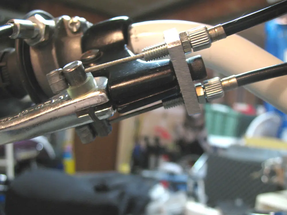

Here is an easy way to do it if you have access to some material and a drill.

that is a grand idea...a project for my crazy neighbor!

Awesome Ghost. And it makes the "pull" even.

I can testify that the factory dual pull style like cruiser posted are not ugly and they work great. I've been using mine for months.
I rigged the front to the inner most pull and the rear pull to the outer. Pretty easy to adjust for perfect balance. Your variety of hand lever may not accommodate the Ghost0 2x pull.
