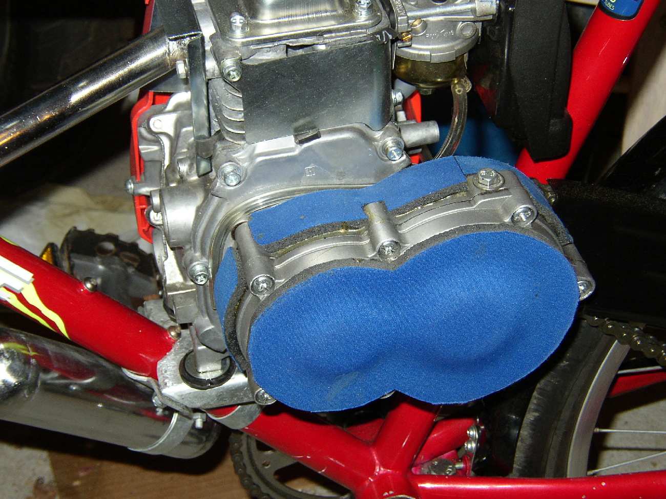

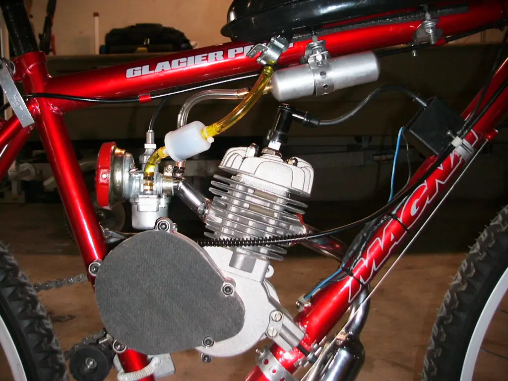

Great to hear how this is working for you. I tried noise reduction from the outside of the box. I used a high quality (thick) mousepad and some contact cement. Other guys have had very good results with this.
Worked for me..........
