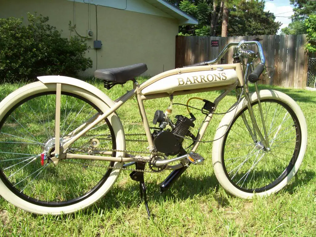

I've used a 25T before. They are very small and fairly common. If you search for a BMX sprocket you should be able to find one. The one pictured is a 25.

wow,that Barrons is sweet

Barron is RedB66's name

Well,?...He has a nice MB then.

thanks! thats just about the diameter i'm thinking.
yes, nice bike btw
