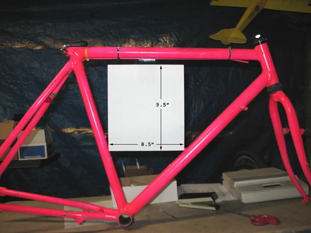

Here is a pretty simple method for measuring.

Old 02-14-2010, 01:02 PM
tyrslider's Avatar
Location: RainCity
Posts: 972
Default Re: Question regarding 4-strokes and frame size.
I stand corrected! That was from memory (been a little while since I installed an HS), forgot you need some space behind them to accommodate the air filter. Duh
That is awesome Ghost0, ty.
