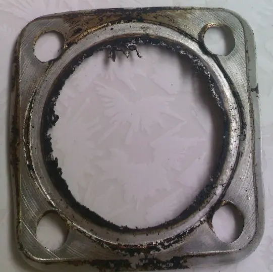

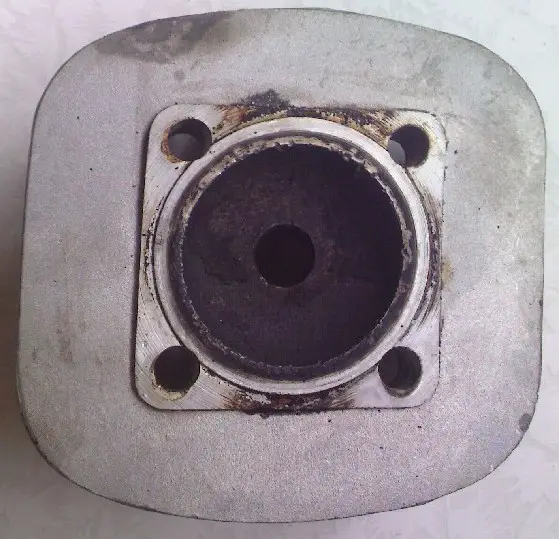

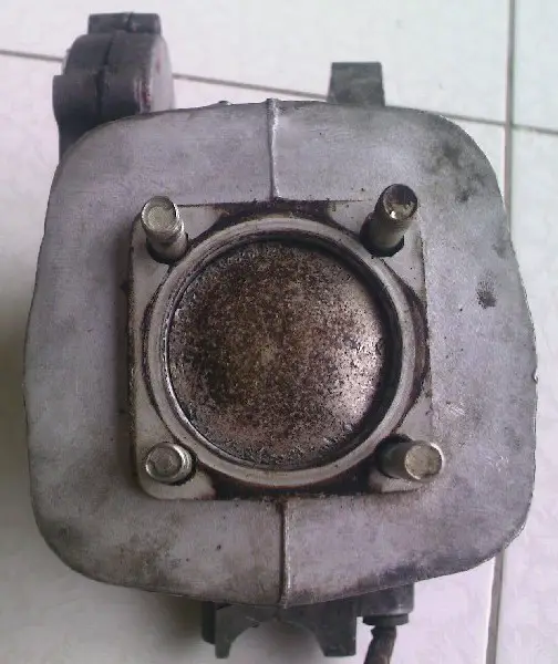

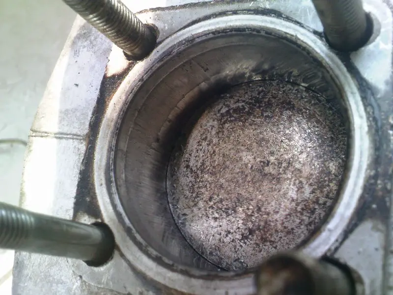

Default Melted Aluminum Head Gasket into barrel... my head hurts... :(
Originally Posted by stv1jzgte View Post
Got a pic??
Here's some pics. Did'nt had the time to dismantle and take pics till now...
As you can see the inner edges of the Aluminum gasket melted, which scratched the sidewalls of the barrel, and made some small holes on the piston head...
I think using a head gasket sealer is better than this Aluminum gasket...

Techno i think thats happened because the gasket can sometimes protrude into the cylinder and is exposed to combustion temps. Either shoddy manufacturing or from being squished alot if its old.

Yeah... Just install a new gasket & recheck your mixture! Make sure the plug tip looks like a nice light brown color! ( & use the right # plug!)
