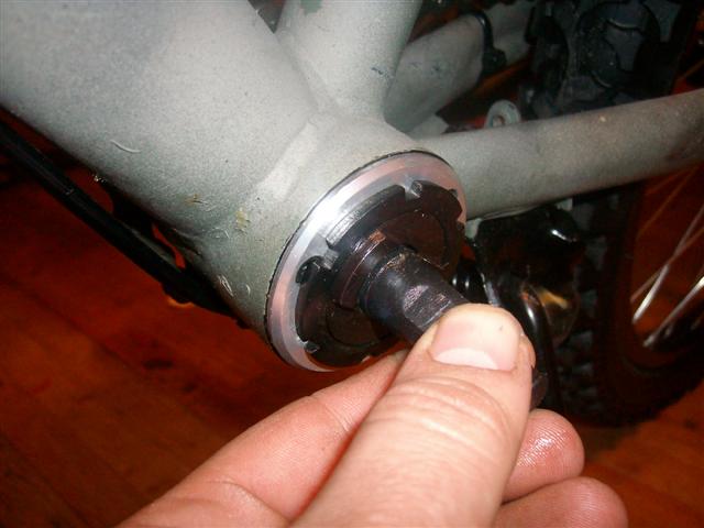

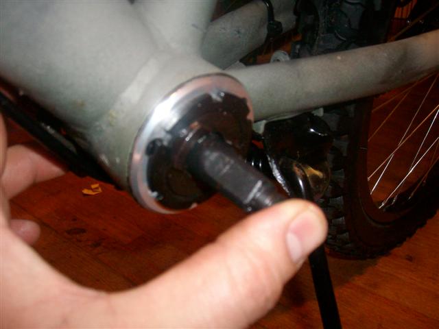

Okay, so I've come upon the first problem that has me truly stumped.
History:
Frame: 10 year old Target "China" special. (Essentially the 10 y/o Target equivalent of the "Roadmaster" bikes that WalMart is selling now)
Trying to install a Dax shift kit. My bike originally had a 1-piece Bottom Bracket. I purchased the 1-3 Bottom Bracket adapter from Sick Bike Parts and installed it tonight.
Here's the problem:
Once installed, the new crank from the shift kit has WAY too much play, I'd say a little under a 1/4", even if I leave just enough threads for the left side lockring to barely grab. I can take the slack out, but if I do, the bearing cup threads disappear all the way into the adapter, and I can no longer install the lockring.

Bearing cup installed enough to remove play (no threads left to install lockring):
Enough threads to (barely) install lockring but about 1/4" lateral play in the crank:

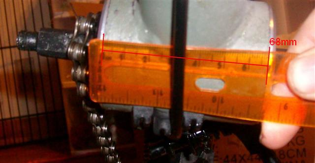

After googling for a while, I came to that same conclusion, at first. But when I went to measure the BB tube to confirm, I came up with 68mm. Unless I'm measuring wrong. Its just the tube, without the adapters that I'm supposed to be measuring, right?
Like this?:
Or is it from the outside of the adapters? If so then I get 74mm.
