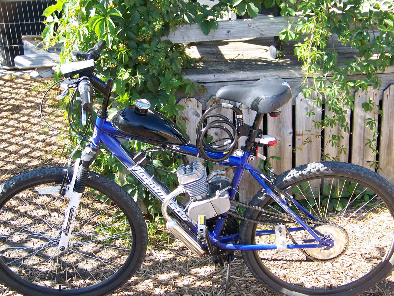

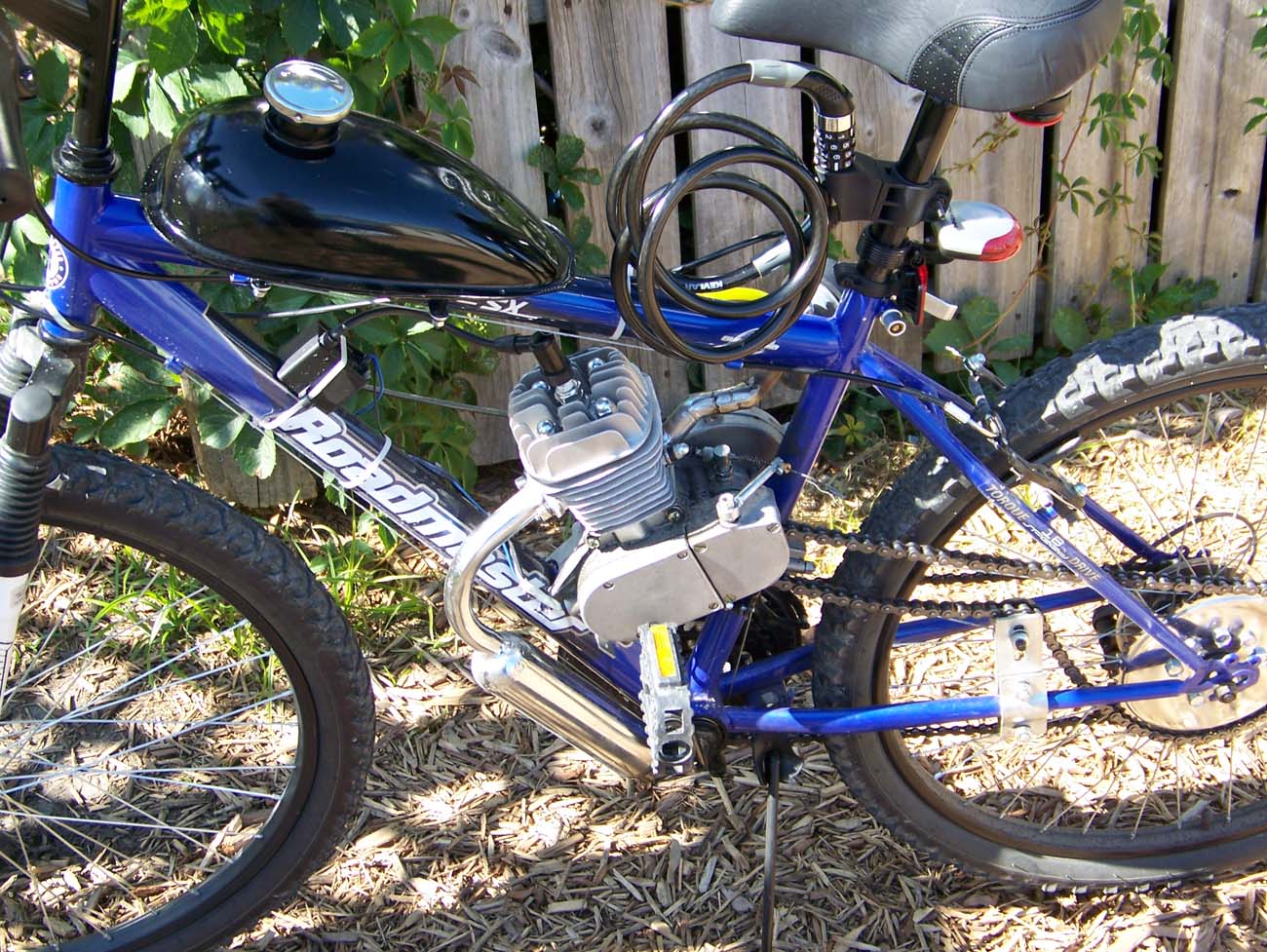

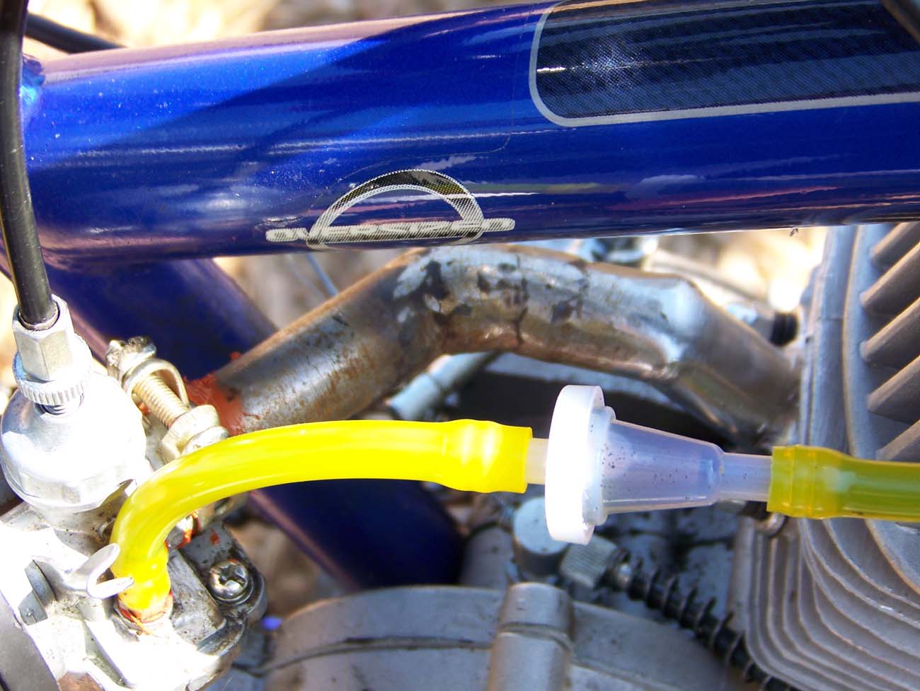

I just mounted an engine on the roadmaster like the first pic and it was a bear, my dad has the second bike and the frame is the same size (made by the same company). The engine will fit but it took a lot of extra work. I would not suggest this bike to anyone. To take the spark plug out I have to loosen the engine mounts and lean the engine sideways a bit. It is only 12 1/2" from top to bottom, when I bought it I didn't know you needed at least 14" for a good mount. it is so close on the top the spark plug wire almost won't fit over the plug. I had to add a carb tube extension with a 45 deg bend so it would go beside the seat post. And yeah the bike is junk, I am going to swap the engine sometime down the road. Probably after the front tire falls off this bike, that will probably only be a couple weeks. I was thinking before there should be a section for people to post what bikes work and don't work, there may already be a stick like this but I haven't seen it. here are a couple pic.
