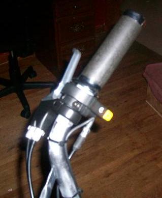

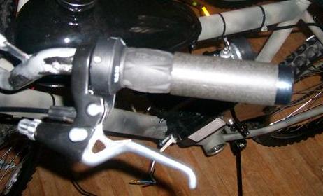

I agree with Vistaman, you remove the shifters and its going to make it real hard to ride when you're not using the motor. Here's how to clear some of the clutter and keep your rear shifter:
Your front derailleur will most likely have to be removed to make room for the engine, so that shifter can go.
Next, get a dual-pull brake lever and put it on the right, so your left side isn't cluttered with two levers (clutch and brake).
Your right side now has a throttle and brakes, to make it a little less cluttered, move your rear shifter to the left side, maybe even switch to a twist shifter if you don't already have one.
Right side with throttle and dual-pull brakes:
Left side with clutch and twist shifter:

all valid points. i'm not going to be doing much of any riding up hills as my towns pretty flat, so i was just thinking it would be like riding a bmx

I did exactly what okfly said. I took off the front derailer, bought a grip shift, put it on the left, and got a dual pull brake for the right. nice and cleaned up. It's nice cause if i want to i can stop and move the chain to the first second or third sprocket, and then still shift thru the gears. I usually leave it on my second sprocket
