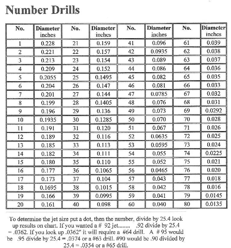

I got this from Quenton. It worked for me a few times already.If the jet is too big, I solder it closed & drill it out smaller using the formula. Learned that from an old friend that use to build hot rods.

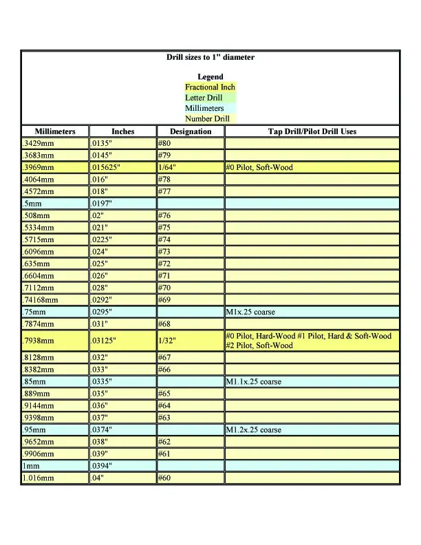

This is a little easier format.

yes, I'm still trying to get it right. it's a chart in Adobe, but shows up weird here.

AAAAAh!! Confession time. The wife showed me how, & I'm the computer whiz in the family. She's better with software though. Mine shows up okay now.
