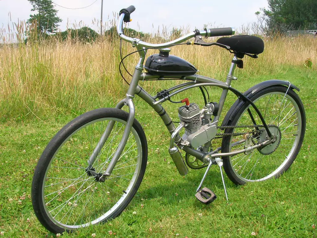

Here's the one I had. Look closely at the frame welds on the bike you are going to buy. They can be pretty good, or absolutely terrible. My rear fender was made by using the front fender turned around backwards.
